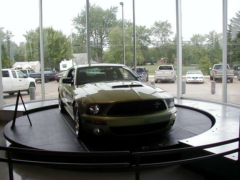

Going to replace the KDW's on my Mustang, currently running 255/35/20 and 285/30/20.
I going to stay with my 20" wheels to clear the Brembo big brakes but I'm looking to get away from the narrow sidewalls and the harsh ride.
I'm considering the BFG G-Force Comp 2's in a 245/45 and 275/40 because I can't let the diameter get past 29"
Plan B is to go with a 19 inch rim but that's at least another $1500 or so and the selection is limited when you're running the big brakes.
What are you guys running?
This is for a lowered, supercharged Mustang with a FRPP handling package complimented with lots of BMR and Steeda suspension upgrades.
I'm not concerned with setting this car up for track days, in the past it has been used basically as an in town hunter and back road carver but I'm looking to start taking it on longer highway trips without wearing my old dirt bike kidney belt.
