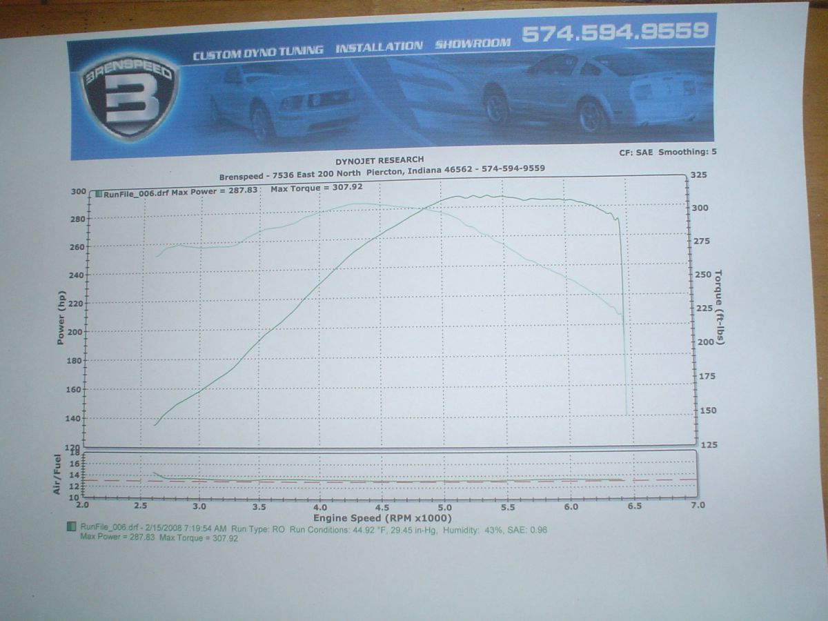

Here's my real world #'s
288/308.
GT Manual w/Factory 18" bullits.
JLT2 + Brenspeeds 93 custom tune,OBX LT's O/R H
& UDPs.
No baseline dyno.
288/308.
& UDPs.
No baseline dyno.
Just out of curiosity, did you print out (or save) an uncorrected chart.
I would like to see more uncorrected runs in ambient cold air to compare (and yours says 44F).
Cold air gives even more real HP, but you want to use SAE though to compare cars or tunes.

No uncorrected chart.Just this one & one comparing his email tune vs custom tune. Difference was + 2/2.
