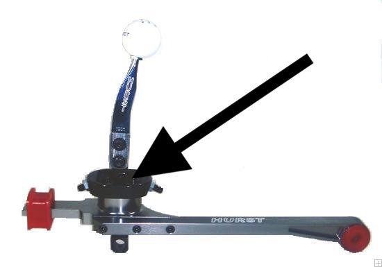

Are you guys that use the grease applying it here? (The picture is from some stock photos and they made the picture with the shifter backwards.)
If that is the right place to grease it....then I got it all wrong as I was thinking it was the very bottom of the black stick
Though I am still waiting for my rubber isolaters from Hurst. I went to a car show in Bellevue this past weekend and I met another guy there who said it just needs those isolaters in between the chrome and black stick....and it should take care of the rattling problem

That's the spot Randy.

This is what Hurst has recommended.....it is suppose to dampen any rattling/vibration.....though I will also grease the area as indicated in the above diagram.
