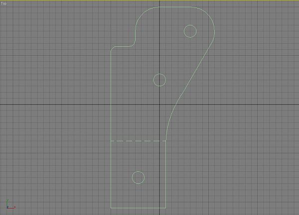

I made my own relocation bracket so I could use the GT500 intercooler degas tank in place of the P/S reservoir. Here is a pic showing the new location and the Roushcharger, etc. It turned out great.
http://i12.photobucket.com/albums/a238/Randy_B/Top.jpg
http://i12.photobucket.com/albums/a2...cket_Close.jpg

Maybe he will be kind enough to post a 1-1 scale drawing/diagram/pattern so we could make an identicle bracket since his is soooo perty...

Lol, maybe for X-mas. I actually thought of making a kit until Ford decided to change the shock tower bracket on the '07-up Mustangs to acommodate the wider Shelby 5.4 engine, rendering my design useless on those cars.
I could probably post the dimensions later tonight if you guys are really interested. At least you know it will bolt straight to the strut tower in case you're as lazy as hawgman.

I'm lazy.. please post the outline/trace on a piece of paper..

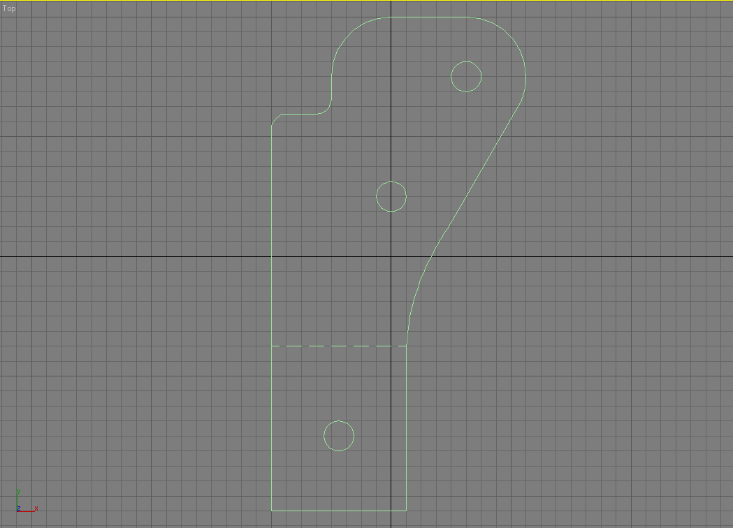

Here are the measurements for the bracket I made. The grid represents 1/8" and the bracket measures 4 1/8" x 2 1/8" and the radius dimensions can also be figured out by using the grid. The dashed line represents where the otherwise flat bracket needs a slight bend for the P/S reservoir to sit level. I hope this helps you out. Have fun and post pics when you're done.

Originally Posted by RandyB
...I made it out of T6 aluminum that is about 1/16" thick. I may get some mild steel at some point and make a duplicate as this one has some minor flex.
A steel bracket might flex even more. T6 aluminum is generally more rigid than steel.
That's interesting. Maybe I will just leave it be. I wish I would have made it from a slightly thicker piece, like ~3/32" instead of ~1/16".
