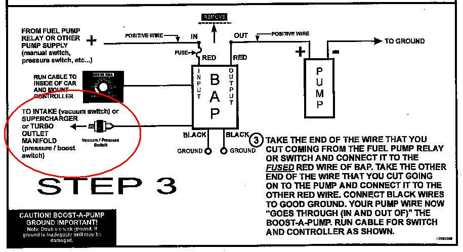

Also, how do you have the BAP connected? Does it turn on at 3-psig boost via the supplied Hobbs switch or do you have it continually working (not using the Hobbs)? Also, when it does work, where do you have the rotary **** set at?

I believe the reason why the engine won't even start when the BAP fuse is in is because it's set at maximum voltage (50 on the ****). Even without it, you're running pig rich. With it, it's even worse, probably so bad that it won't start....
Do you have the 20 or 40-amp BAP? I have a 40 and it uses a Hobbs (vacuum / pressure) switch. See attachment.
Willie
