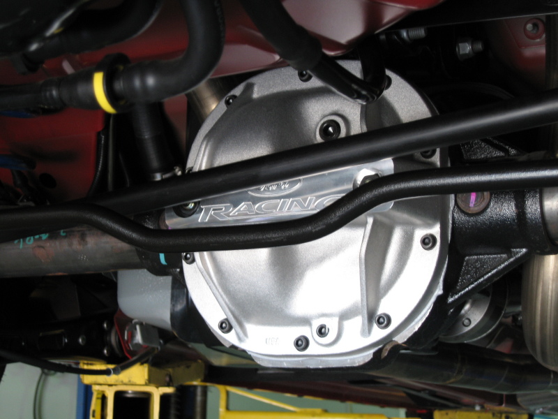

Get one of these and be done with it.

Early '07's had the shiny covers and somewhere along the '07 model year they went to painted.
If I had the painted one, I'd get the one Taco Bill has. That is sweet!!!!

I have the FRPP girdle on my other Ford 8.8" and it is a waste of money. It came with cheap black oxide bolts that required a hex head to tighten, and the drain/fill plugs are also black oxide. Black oxide will rust VERY easily. You can swap them out for SS but it won't be as strong as the black oxide bolts. Zinc-dichromate will stay rust free but not for long. It adds unnecessary weight and doesn't offer any substantial benefit over the stock cover.
