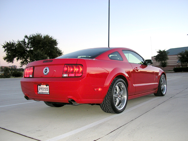

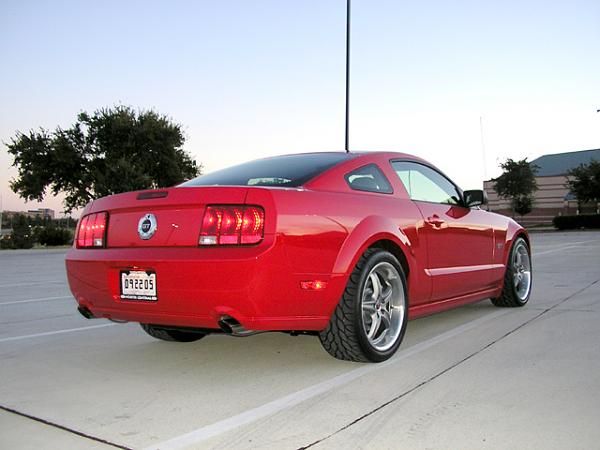

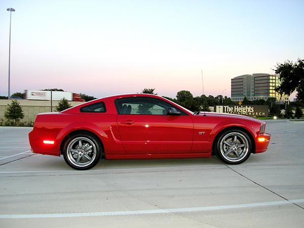

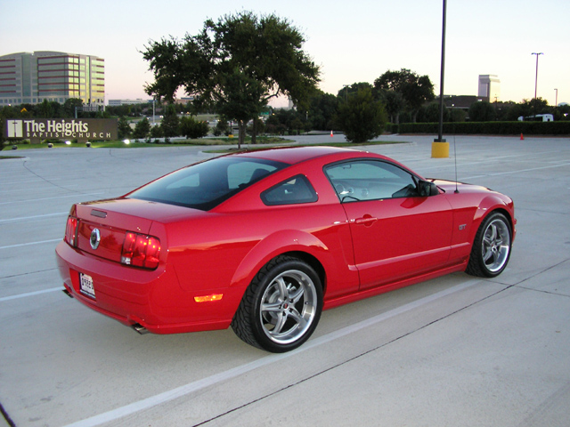

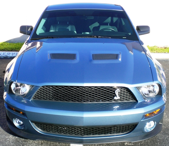

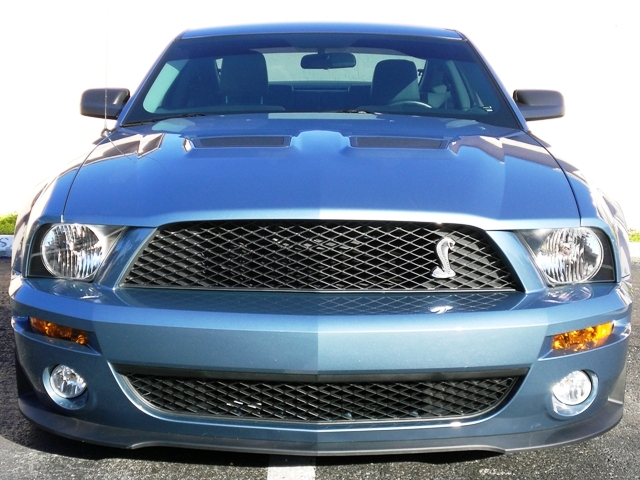

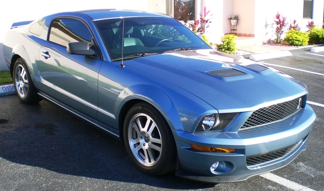

I have those springs and I'm very happy with them. I'm also still running stock shocks and struts for now, but I do plan to get Bilsteins eventually. The drop is just as they say - 1" F/.75" R. Here are a couple pics.

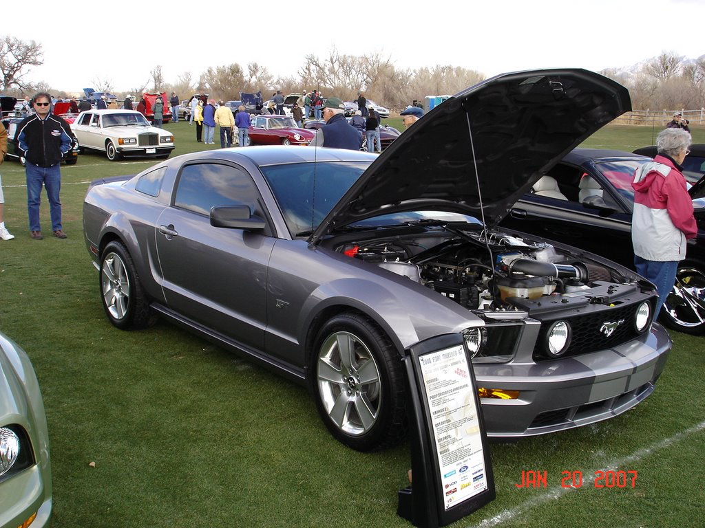

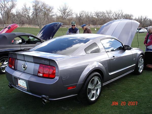

Not much. My dad happens to be the front end tech at a Cadillac/GMC/Pontiac dealership. We did the springs and tires on his lunch break about three weeks ago. I still have the printout. We were in a hurry so we didn't baseline. My right camber is -.2 out of spec, nothing to worry about, left camber was still in spec. Left toe was out of spec -.30 and the right about -.10 out of spec. So we just dialed in the toe - He gave me a straighter toe than spec since I mainly do highway.

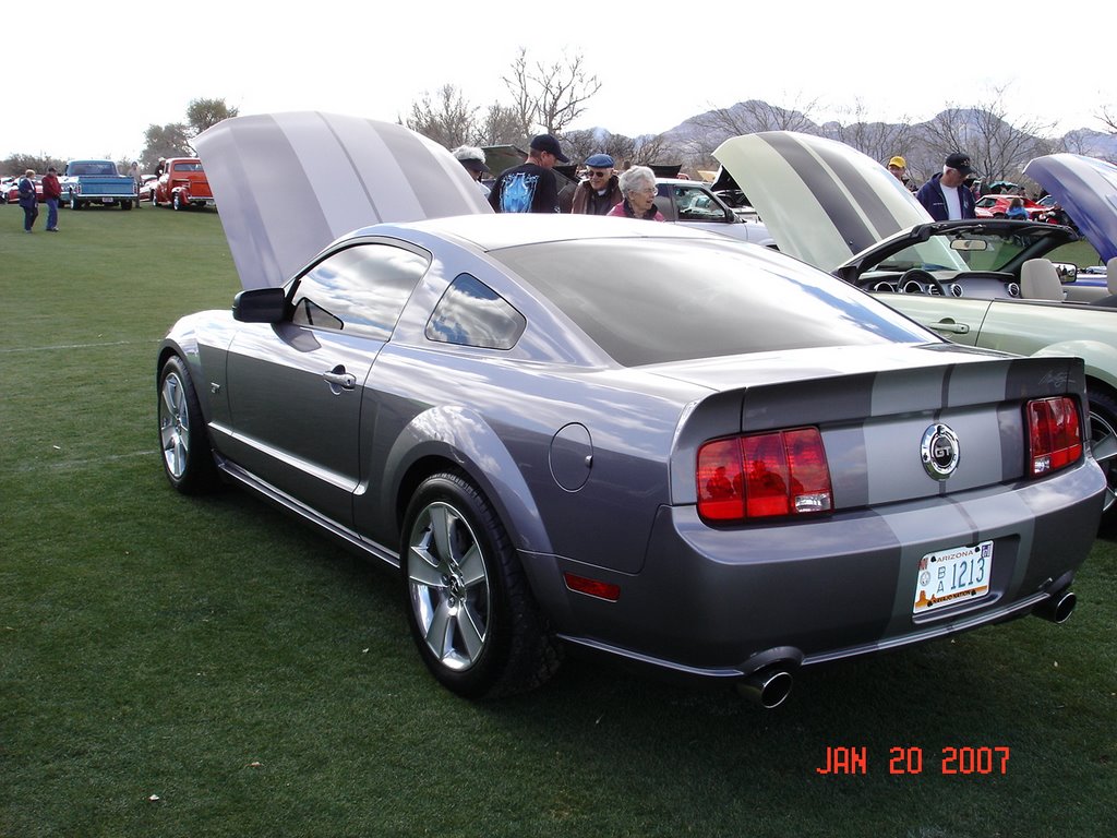

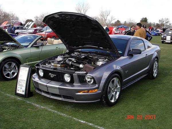

Here's some pics also. Took third place in the '79 and up Mustangs.
Attached Thumbnails Ordered H&R sport springs, should I do shocks at same time?-1-27-2007-10w.jpg   Ordered H&R sport springs, should I do shocks at same time?-1-27-2007-11w.jpg   Ordered H&R sport springs, should I do shocks at same time?-1-27-2007-12w.jpg   Ordered H&R sport springs, should I do shocks at same time?-1-27-2007-13w.jpg
cool! what size are those wheels/tires. I'm sticking with OEM size wheels /tires for a while yet, but looking at those H&R + Tokico
The rolling stock is 19x9F/19x10R ROH Drift R wheels with BFG KDW 275/35-19 and 295/35-19 tires.
