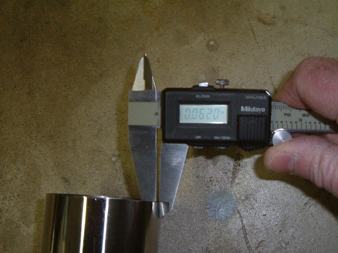

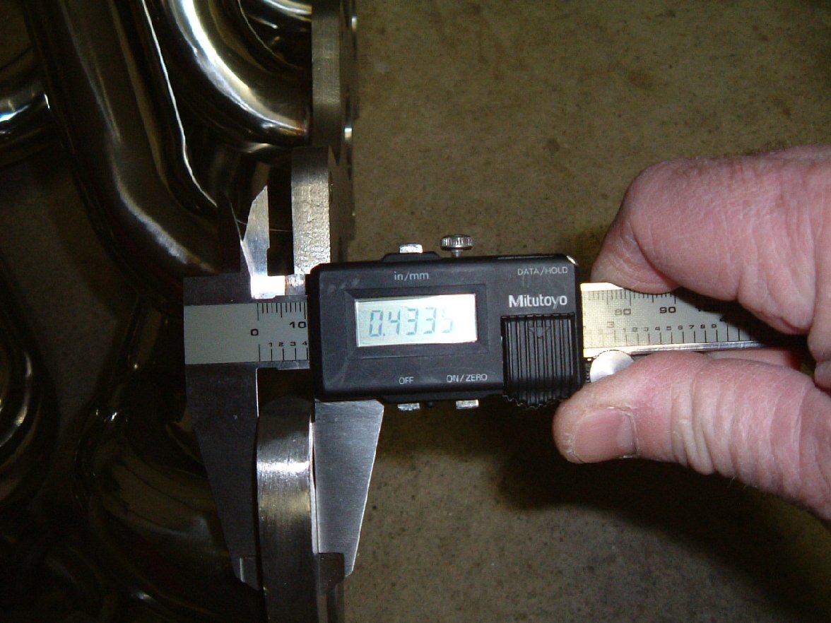

The ones I bought advertised them at 1 1/2, but 1 5/8 is only .125 inches bigger so it wouldn't affect performance on a N/A motor. I should have mine in hand tonight, so I will measure and let you know. 70MACH1OWNER did a write up on his experience with installing 2 sets, he wrote:
"Here are some facts about the OBX Headers.
1. They are truely made from 304 SS. (no magnet draw)
2. Primary size is 1 5/8 dia.
3. Tubing wall thickness on all primaries, and H-pipes is .060 thick (16 ga.)
4. Header flange is 3/8 inch thick or thicker. Both Larry's and mine measured about 7/16 thick."

They are 1 5/8 dia. and are .060 tubing thickness and the flanges measured close to 7/16 thick. I measured all of these areas when I got mine. I have even seen them advertised as 1 3/4 primaries. Hey Dean I must have been uploading this pictures when you made your post. But you are correct on all counts.
