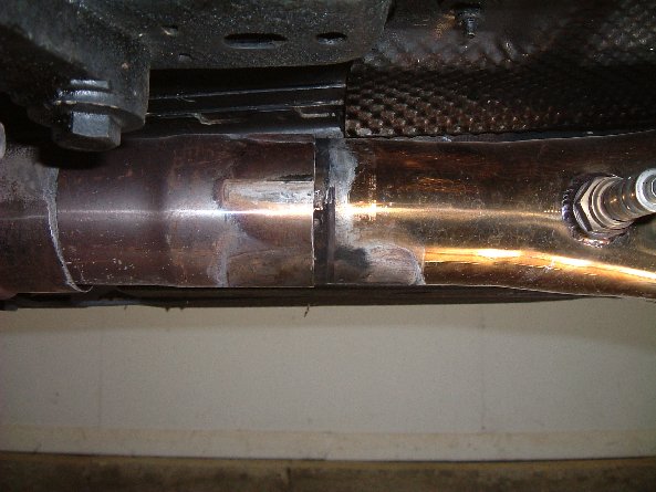

The OBX header and h-pipe are a slip joint type of fitting. The OBX header (on right) is 2 1/2" in dia. The H-pipe (on left) is flared to slip over the header. There is a band clamp that then goes around this joint. I have removed it so you can see better. Next the headers collectors are on a 24 1/2 " centerline where the h-pipe slides over the headers. Hope this helps alittle.
Scott
Scott
Sweet, ordering some next Friday. Need to start making sound clips.
