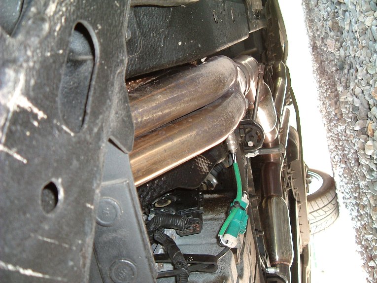

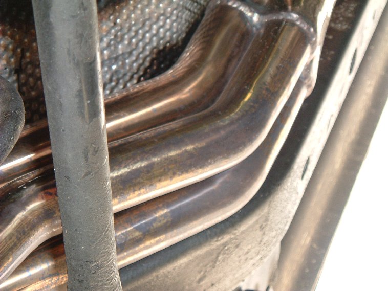

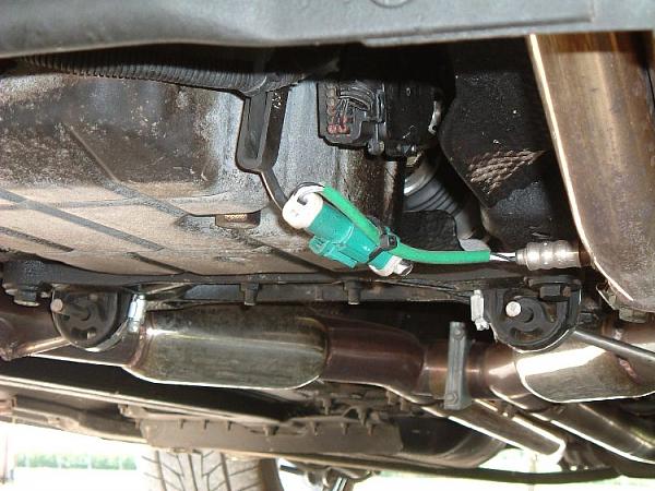

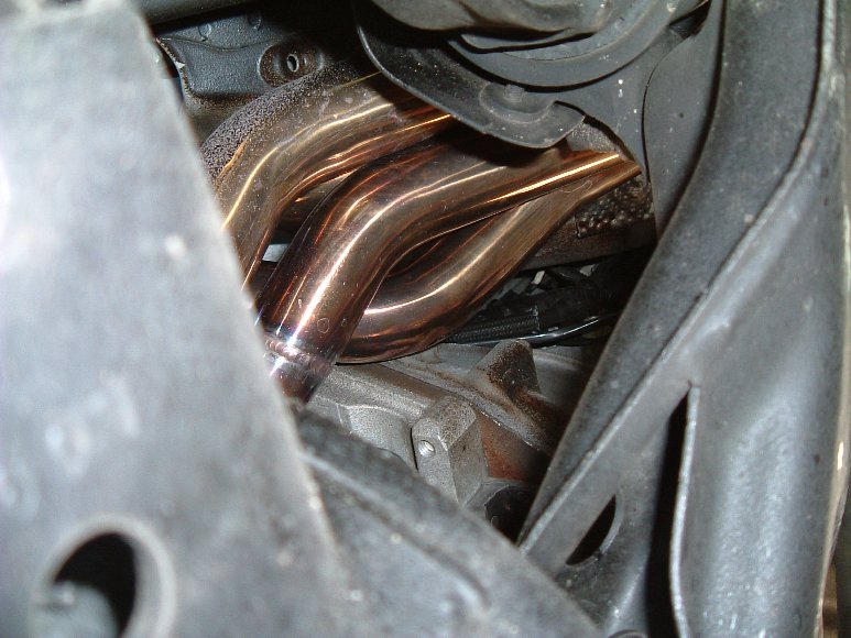

Well I was under the car tonight changing her oil and while the pan was draining I was laying there looking at my OBX headers and remembering back when I post this thread about a certain guy (going un-named) that bashed my Chinese headers for the quality of the stainless steel, the welds and about anything else bad he could think of. So I decided to take a few pictures of what mine look like after almost 10 months and 7,000 miles. For the record my car is a daily driver...rain...shine...snow...or salt. These headers have seen it all. You guys be the judge. For the record they are not made in China I believe Japan or Tiwian (spelling) is more accurate. But my point with this post is after 10 months with my cheap, inferior headers I still have had not one issue with them to date. I post this for the guys that might be on the fence about the quality of the OBX header. Don't be afraid to buy them!! You may see some black stuff on my headers and wonder what that is. I have my car undercoated (Zeibart) they are not very careful.

They look good Scoot...

Yeah Scoot they look good.......
