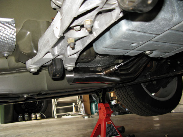

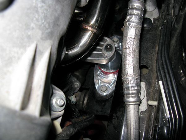

Headers and Mounts
Thanks to 70MACH1 for his tips on the header work. We needed to jack up each side of the engine for easier install with the headers so while the engine was up we installed the mounts. The mounts also provided better clearance. For more details check out: http://forums.bradbarnett.net/showthread.php?t=461710
The driver's side header went in from under the car. Make sure to check for clearance with the steering column. If you are using the stock mounts you may need to flatten the part of the header that is close to the steering column. We took off the starter on the passenger side and dropped the header in from the top.
The stock O2 sensors would not reach, so I picked up a set of Bosch sensors with added length. You could also DIY with a solder gun and wire.

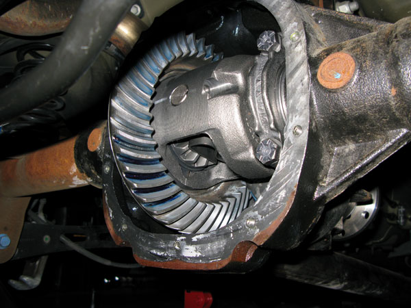

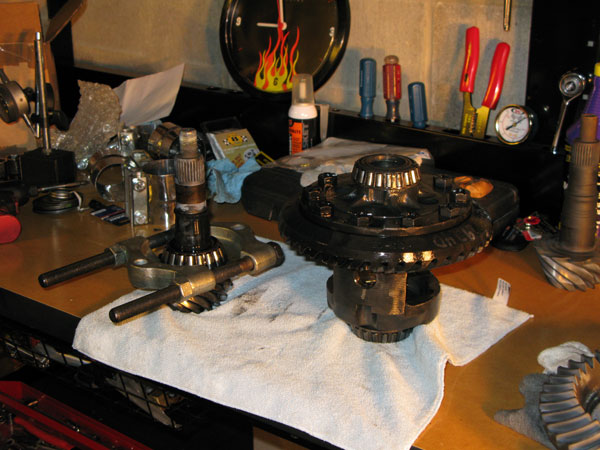

Gears
We ended up using some shims that were not included in the kit to get the gears just right. See:
http://www.corral.net/tech/drivetrain/gears.html

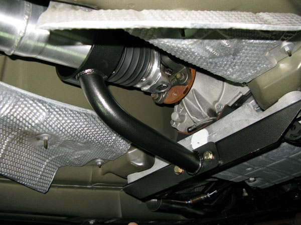

Driveshaft Pinion Flange and Loop
The clearance under jackstands made it a bit difficult to get the crush sleeve to collapse and get pre-load torque. The driveshaft install was easy with the H-pipe out. Check out the following thread for more details: http://forums.bradbarnett.net/showthread.php?t=464439

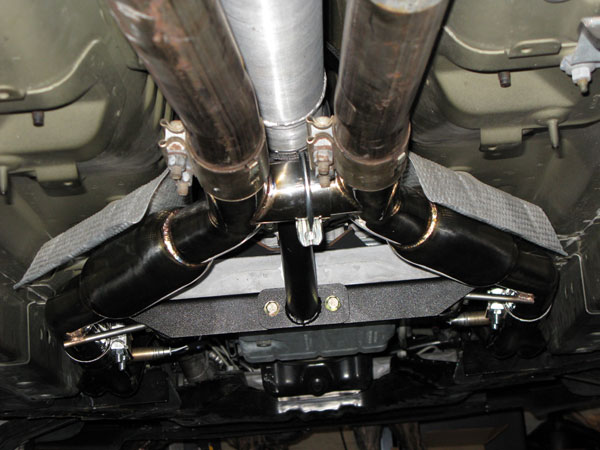

H-Pipe
The H-pipe was a tight fit. There was a bit of pounding on the hangers and such to get them to slip down.

The next rattle was from the passenger-side muffler tip hitting the bumper. This was fixed by lowering both tips so they matched and had better clearance.
The biggest rattle came from the over axle pipe. Initially we had pulled the exhaust and tips out somewhat. Doing this pulled the over axle into a position where it was hitting the trunk. We fixed this by pushing the tips and pipe back in to get clearance. Still looks good and no rattles.
