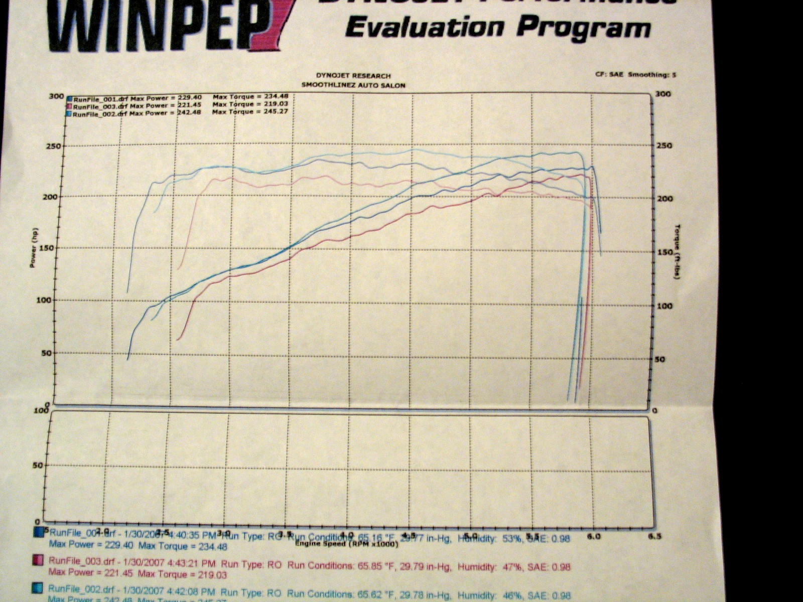

Here's the graph:
Attached Thumbnails Just dynoed my car today..do I have a lemon?-img_0343.jpg

Old Jan 30, 2007 | 07:31 PM
tom281's Avatar
Joined: October 8, 2005
Posts: 12,395
Likes: 29
From: Medina county, OH
No air/fuel monitoring? That would be helpful too......
