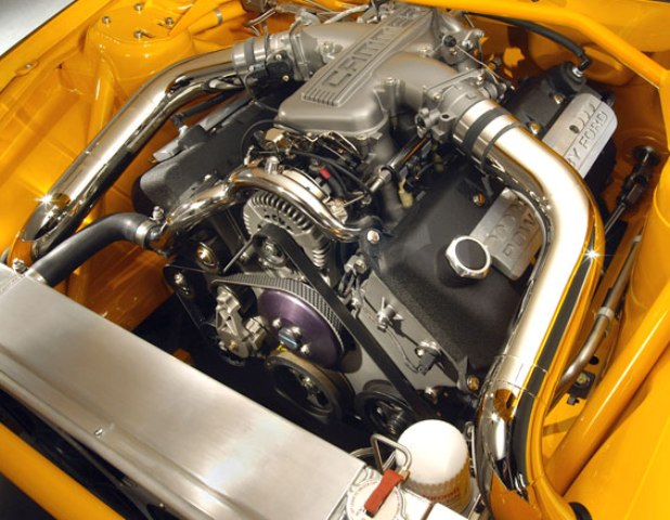

Talking Drop one of these in and bam !!!!
Just like that you have 400HP.
Attached Thumbnails How to make 400hp N/A-my-engine.jpg
