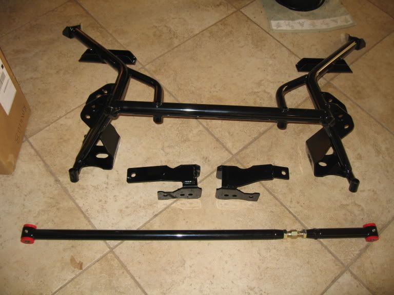

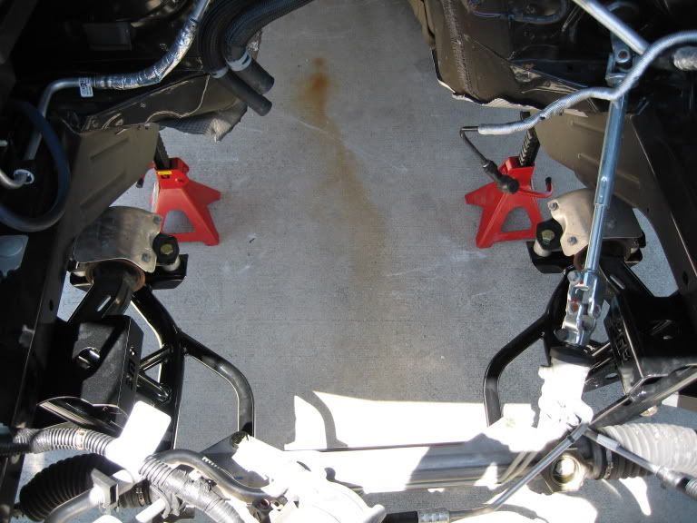

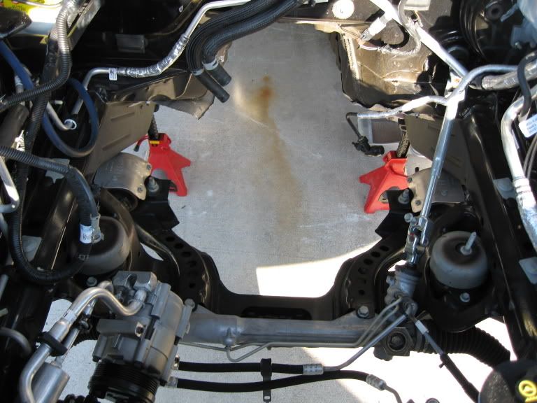

I received my BMR K-member, LCA relocation brackets, and adj panhard bar last week and this weekend was all business. The panhard bar and relocation brackets were very straightforward so I did not take any pics and the K member was not tricky or anything either but I decided to snap a few before and after pics to show the added clearance you gain with this thing.
Before:
After:
Very straightforward install and it helped that there was no motor in there (Should be getting that back very shortly from Boss330). The install took me 4 hrs but I was putting in the Tokico D-specs at the same time since everything was apart. One note I would like to make is that in the instructions it says to seperate the bottom ball joint but I did not have to do that which could save some time especially since its hard to get a BFH in there. [img]style_emoticons/<#EMO_DIR#>/rolleyes.gif[/img] I will be getting an alignment as soon as the car is back running and let you all know how it feels-it definately gives added clearance and thats a plus since im planning on a turbo soon and all that extra piping has to go somewhere. -Jan

is that the k-member with motor mounts or without motor mounts...i can see that the stock ones are gone and replaced by the kmember, but it looks like there is only a hole for billet ones rather than replacement of them
sorry for the dumb question, but im doing those same mods very soon
Old Apr 18, 2006 | 12:33 PM
BMR Fabrication Inc.'s Avatar
Joined: September 8, 2005
Posts: 60
<div class='quotetop'>QUOTE(stkdidy @ April 18, 2006, 1:04 PM) Quoted post</div><div class='quotemain'>
[/b][/quote]
He hasn't put them on in that picture yet.
