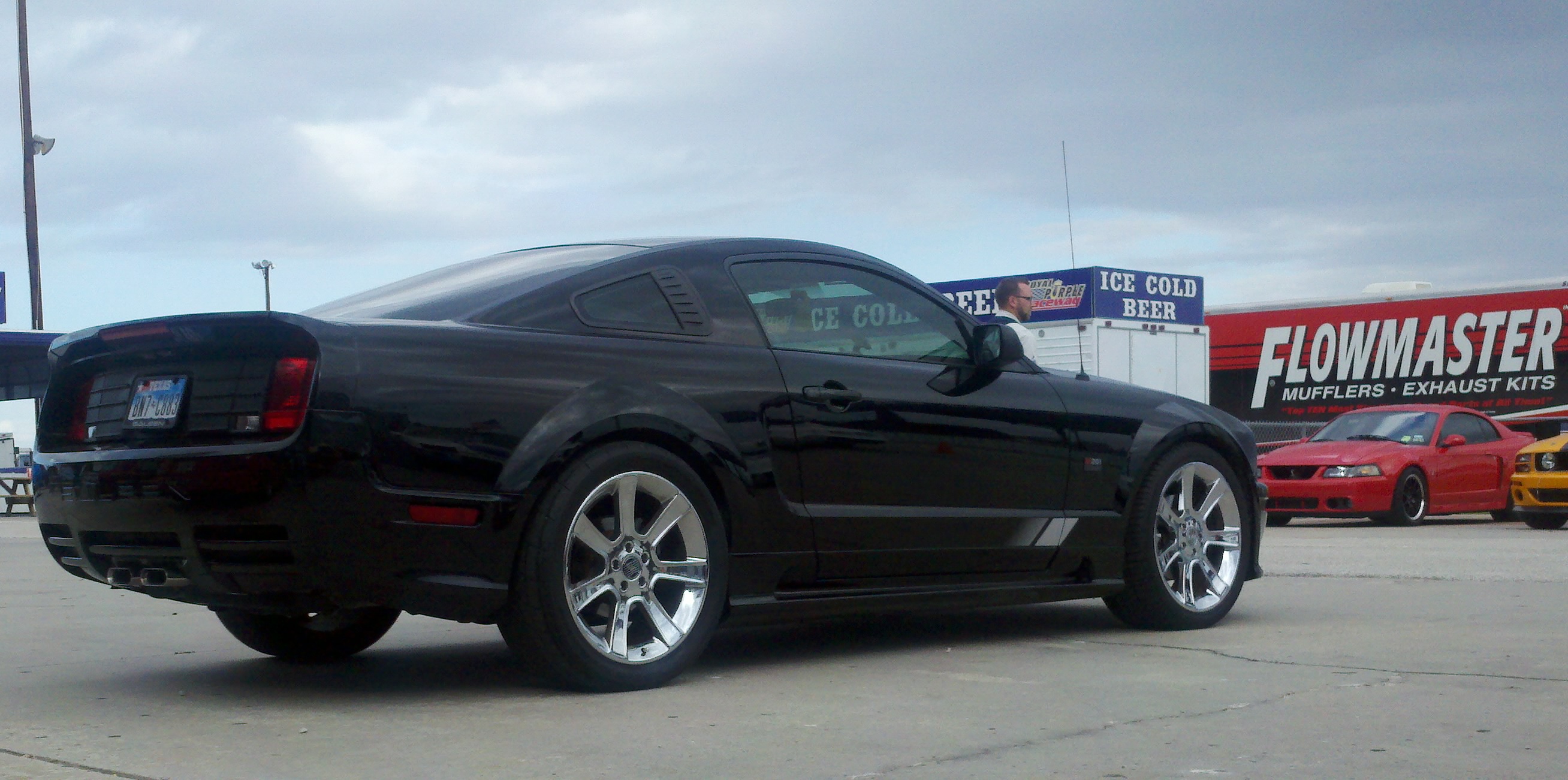

Here's a few shots of my car.

Old Sep 10, 2012 | 10:23 PM
Getportfolio's Avatar
Joined: July 7, 2012
Posts: 4,421
Likes: 21
From: Indianapolis
What a beauty. Congrats bro.
