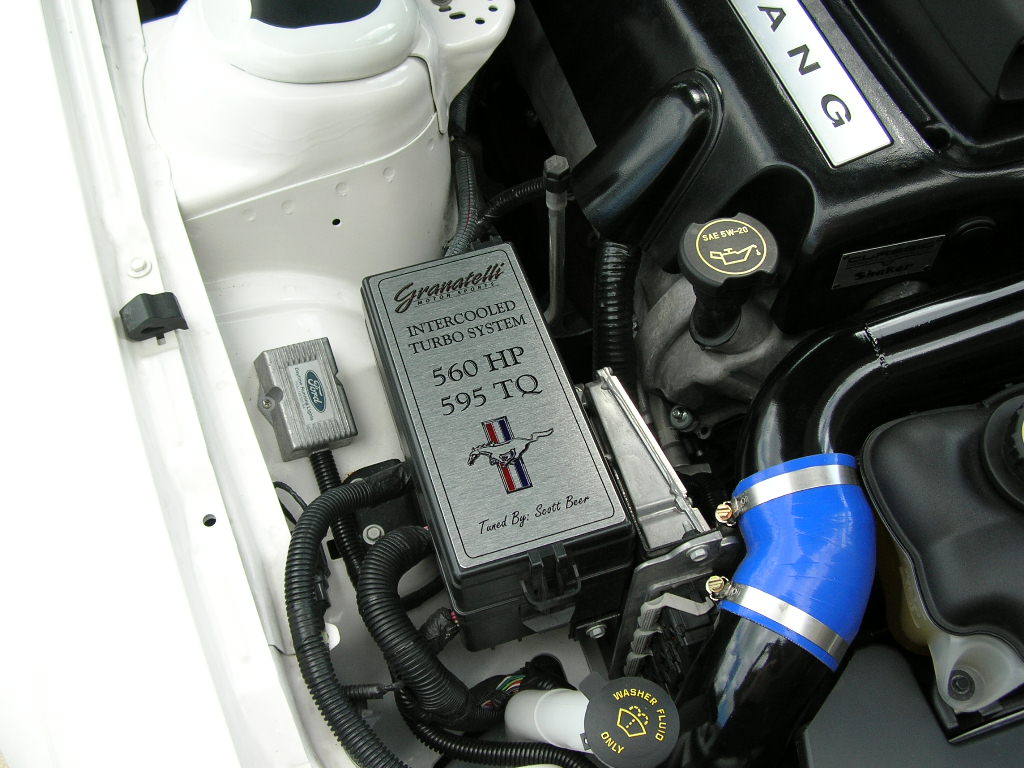

Here's how the tag turned out:
Granatelli Turbo Install - The Final Outcome!-dscn7561.jpg Granatelli Turbo Install - The Final Outcome!-dscn7562.jpg

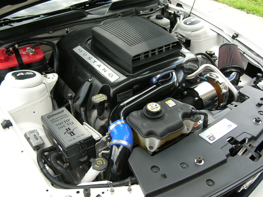

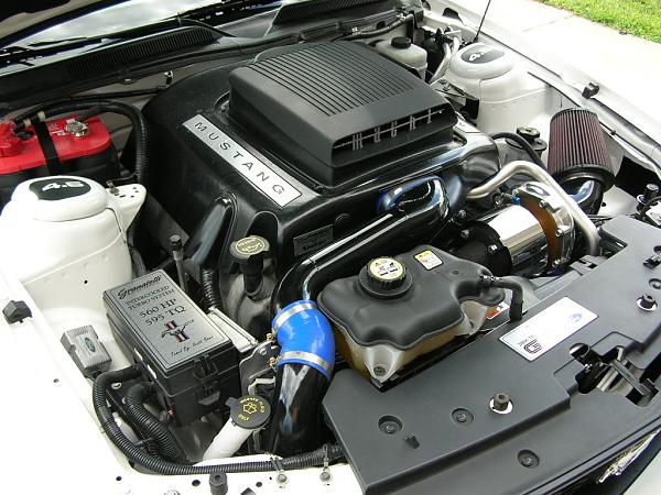

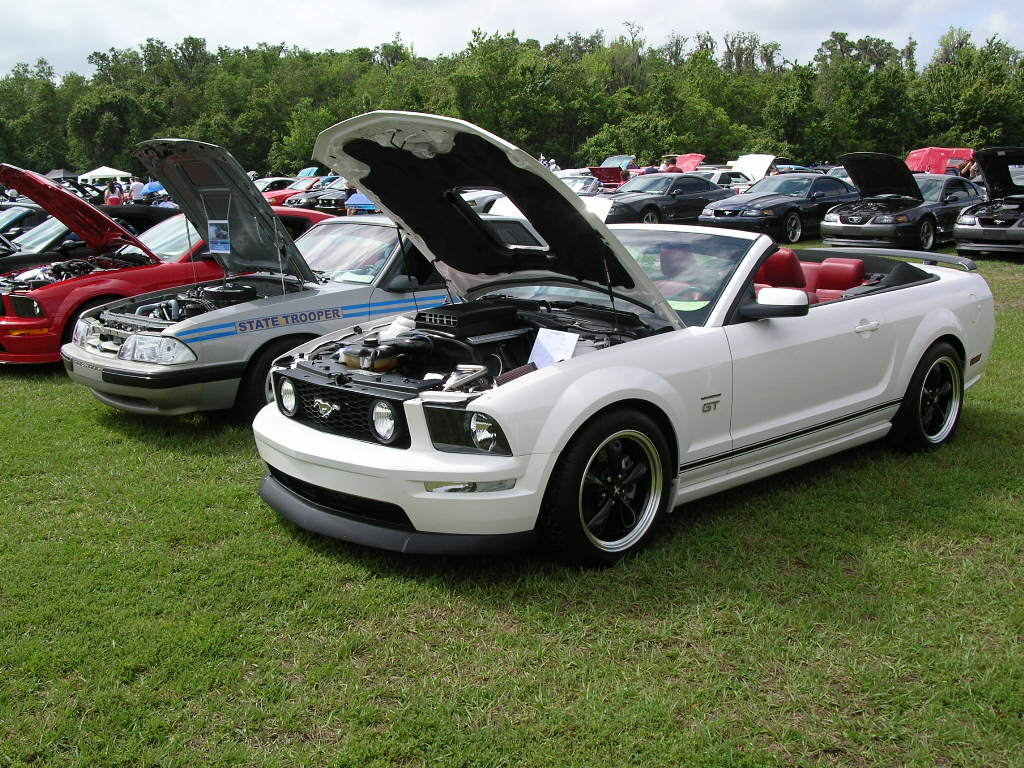

The car got a People's Choice award at the last car show I was at. Tons of 2005+ Mustangs and only 3 awards given in that class... guess the Turbo was definitely an attention getter! Huge show and I didn't see even 1 other turbo there.
Granatelli Turbo Install - The Final Outcome!-dscn7586.jpg Granatelli Turbo Install - The Final Outcome!-dscn7592.jpg

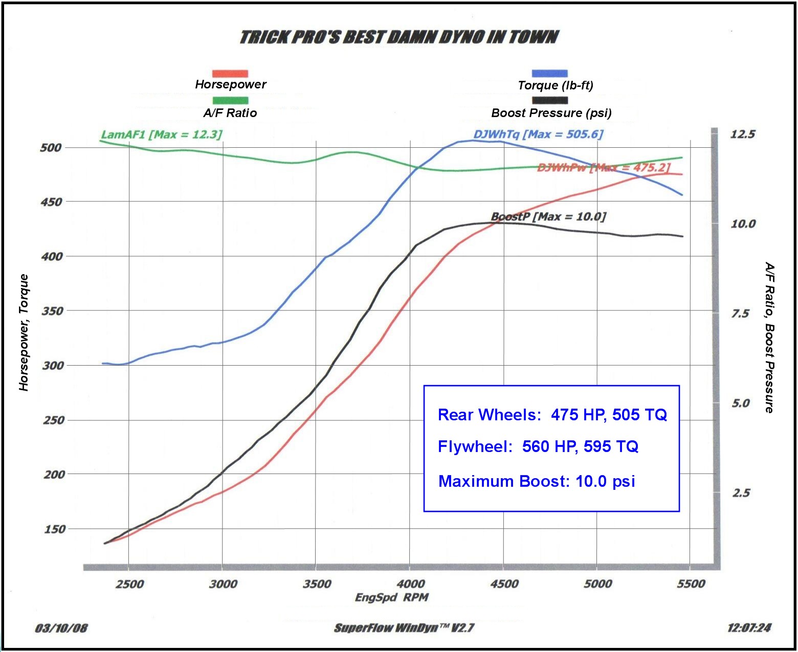

I actually helped the lag by installing a boost controller. It holds pressure on top of the wastegate spring to prevent it from starting to open earlier than it's preset rating of 6psi. Now the boost controller holds it shut until whatever I set it at (10 psi in the chart below).
Obviously, with the spring opening earlier on, it was harder and harder to build boost the higher the RPMs got and the more the spring opened.
Now, boost comes in pretty steady and the boost controller removes pressure from the top of the spring to let it level off:

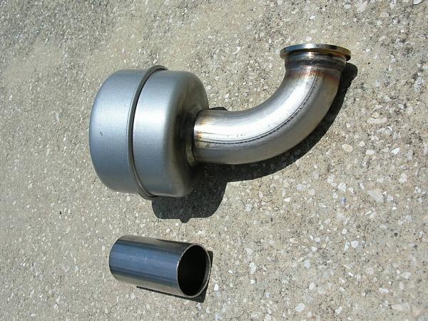

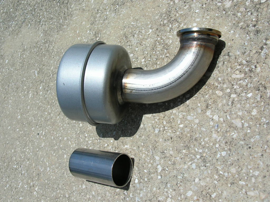

Update:

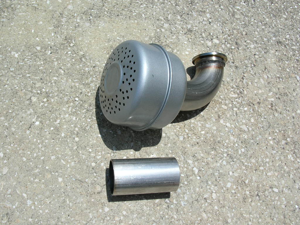

I got rid of the boost controller and changed the spring in the wastegate. Now at WOT, the boost gauge ramps up quick!
I also had a muffler welded on the dump pipe coming out of the WG. Now instead of raw exhaust sound coming out of there when the WG opens, it's nice and muffled.
Granatelli Turbo Install - The Final Outcome!-dscn7761.jpg Granatelli Turbo Install - The Final Outcome!-dscn7762.jpg
Going on 7 months with the Turbo installed and about 7000 miles without any problems! And that's with 560 HP / 590 TQ at the flywheel on stock internals and with a stock fuel pump.
