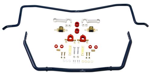

Well I am getting the front and rear sway bar kit installed at the dealer on feb 6th, I would like to know of those of you that have this kit, what do you have your front bar set too. It is adjustable I believe and has like 3 different mounting points. If you have this set up would you please post your feelings about the different points of adj, and what is the most performance related, and which is less etc. I am assuming the middle position is probably the best unless your seriously racing. But thats just guessing. any hints on this set up, thanks for any info.

Reason I ask is that the larger bars front/rear with the front bar set in the middle will give you roughly the same balance. I adjusted my front to full soft (outer most hole) because I have smaller tires up front as well as the additional weight of the SC. By adjusting to the softest I am promoting oversteer which in my case balances the car to near neutral.
So, if you like the current balance, use the middle hole. If you want to promote oversteer, use the furthest hole. If you want to promote understeer, use the innermost hole.

I would start with the middle hole and see how your car is working. What works for someone elses car may not work for your car or driving style, experience, etc.
My experience started with the middle hole and I could indunce controlable oversteer. At the rear/softest position, I had wild oversteer which was fun, but not good for my track times (also did an unintentional 360 in light rain on a freway on-ramp). I ended up running at the forward/hard setting which made the car easiest to drive at the track. Then, after going up to 350lb front spring, replaced a worn out rear end and installed urethane LCA bushings, I'm back to the middle position.
