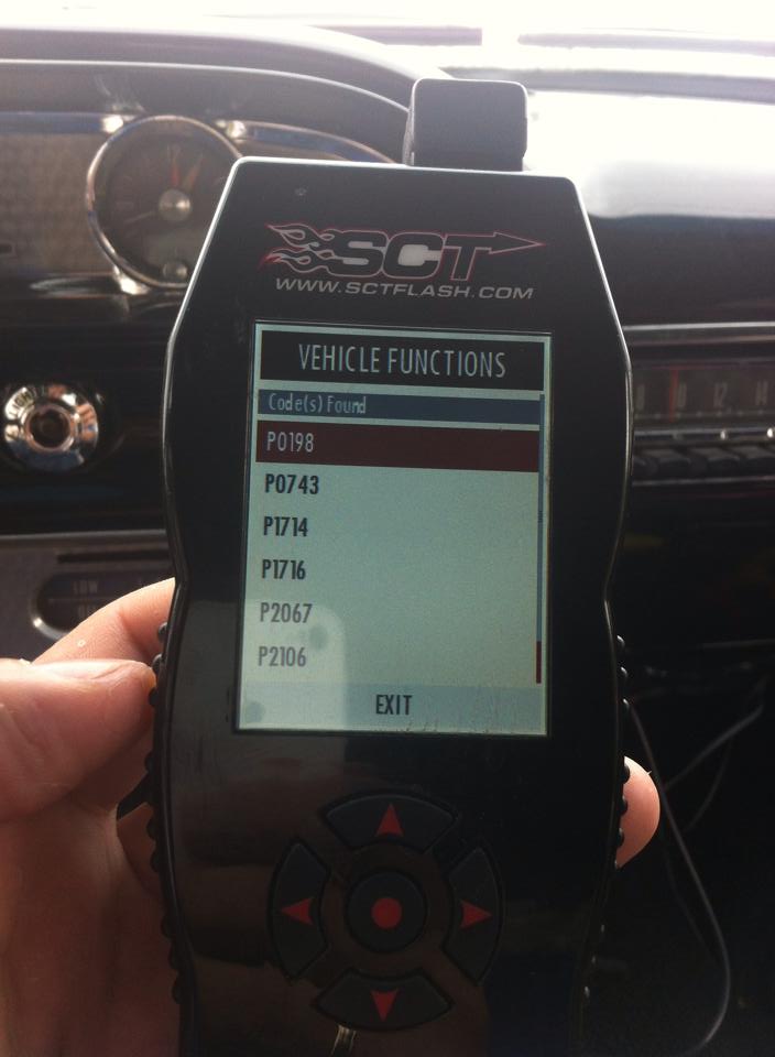

Got some problems with my engine. When i was out driving last night the engine died out many times for me. It starts right up again but sometimes it goes "unclean". someone got a clue whats wrong.
Here`s the errors i got

Find out what the codes are by doing a google search.. Once you find out what the error codes are ? Then you can trouble shoot what's causing them !

Those codes are for various sensors, from oil temp, to throttle to transmission. My guess is that either the harness has a short or is damaged/loose somewhere, the battery/alternator are on their way out, or the PCM or similar component is on it's way out.
I would have the battery and alternator tested first. A failing alternator could be supplying the electrical system with too low a voltage, which will cause the engine to run rough/stall, and will cause most sensors to malfunction and draw a code.

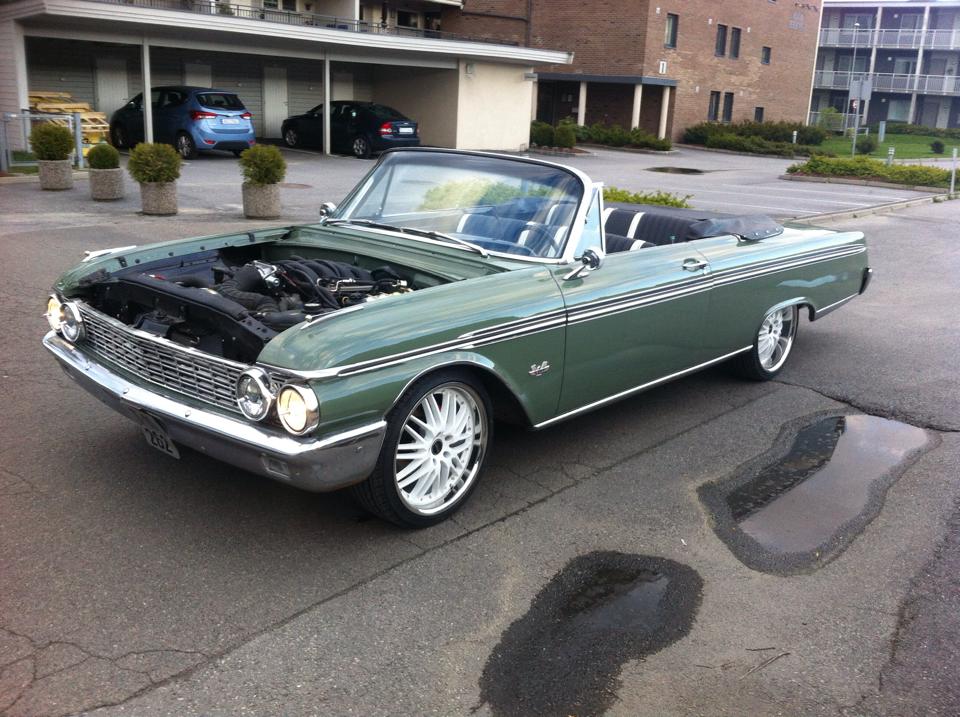

I have this engine in my 62 Galaxie by the way. engine and autotrans from 05 Mustang 4.6 3v
