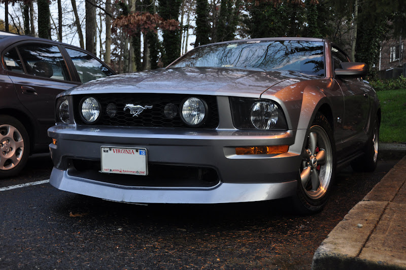

My driving lights only come on with highbeams and seem to shine together for a 1/4 mile or more.
Flick the stalk switch and all I show is regular low beams.
This is the original thread from when I did the conversion:
