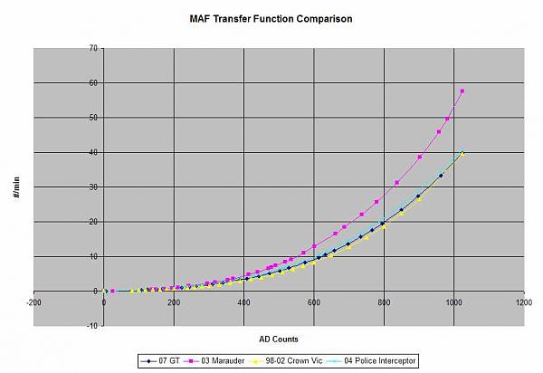

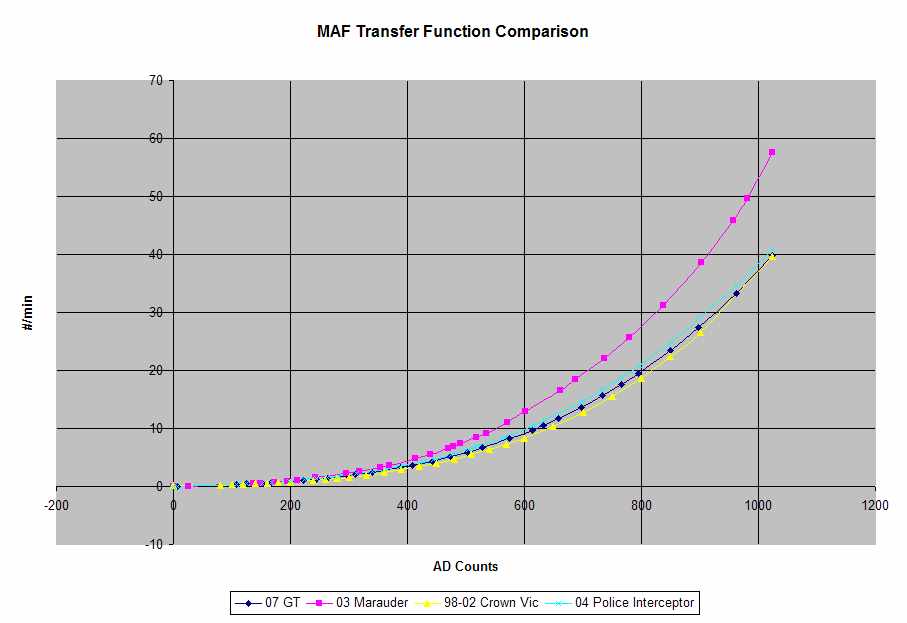

It is not a big deal. I know paper filters work better for filtration. If you want to talk about flow, then consider that the 2003-2004 Mercury Marauders use 80mm MAFs with paper panel filters straight out of the factory. They can run 12 seconds in the 1/4 mile using the stock airbox, stock MAF, with the factory stock paper panel filter and a Trilogy blower kit. In fact, the stock Marauder airbox + MAF adds about 15-20 hp on the regular N/A 4.6 2V Crown Vic. Ford did something similar w/ the 2004-up Police cars. They used a straighter inlet tube with a larger 80mm MAF to achieve 250 hp versus 239 hp for the non-Police 04-up Panthers.
I think it is just more profitable to make/sell CAI kits with fancy cotton gauze filters for the performance-oriented community, rather than develop a “boring” low-restriction airbox/lid and use a larger MAF with an air transfer function suited for more horsepower.
The biggest restriction that I can see in the S-197 GT intake is the airbox lid and stock MAF sensor. The air transfer function for the stock 07 GT MAF is almost identical to the 70mm factory MAF on my 2000 Crown Vic (pegs out at a meager 39 #/min). I’d expect gains of 10-15 hp on the GT just using a larger MAF and an optimized airbox/lid with the stock paper panel filter.
Here is a chart for your viewing pleasure!
The aftermarket S-197 GT CAIs that produce significant hp/torque gains have air transfer functions similar to that of the 03 Marauder MAF (like the C&L CAI kit). That's also why CAI kits that require the stock factory MAF only produce minimal tq/hp gains. While the filter and airbox are changed in the equation, the biggest restriction remains: the factory MAF.
