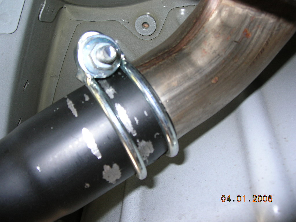

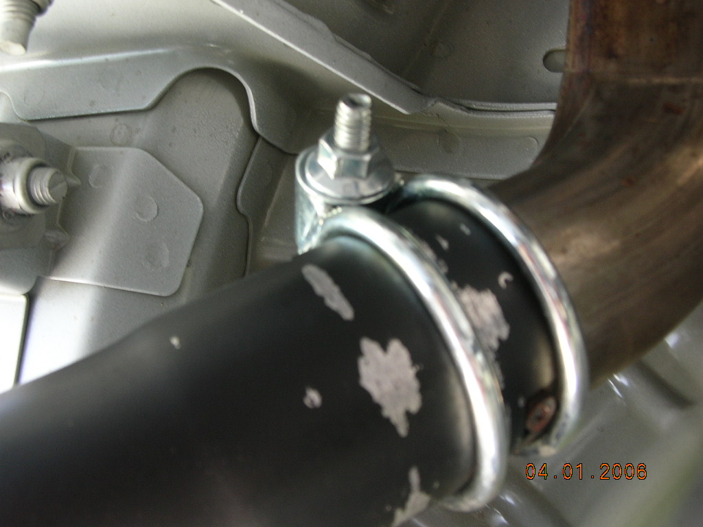

Personally, I hate saddle clamps since they don't give an even clamp all the way around. There really isn't any pressure on the sides of the "U". They'll hold tight, but don't overtighten them or they could cause a leak.
I used the clamps that came with the flows since they are designed to clamp around the full 360 degrees. I put half of the clamp on one side of the nipple as shown in the first pic. You can see that I didn't do that at first (from the missing paint), but I then moved them to where the pics show now. There are zero leaks and they are impossible to pull off because of the clamp against the nipple.
Attachment 15908 Attachment 15909
I did the same thing and it's been about 9 months no leaks, no rattles no problems.
I tried that... no go... even torquing the bolts down with a 1/2" breaker bar. A month later, the clamps were loose and the Flows were rattling again.
I've had the saddle clamps on now for several months and I am extremely happy.

Tom and Daryl are correct... many have been successful in this application, however, saddle clamps worked for me from the start with no rattles or leaks. Whatever works...
