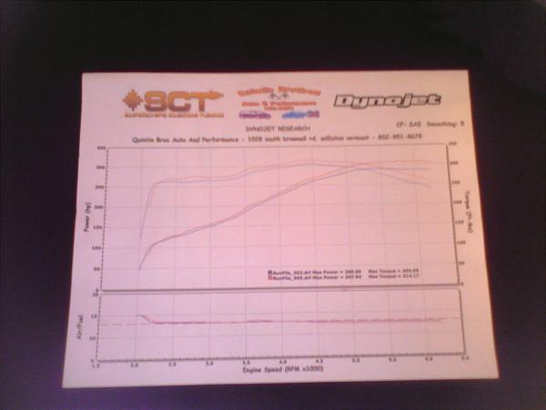

I'll have a video up in a day or to.. Yes the cams are stage 1, They have a 480 lift my tuner said they are worth 25 rwhp but coupled with the 410's i lost about 6-10 rwhp.... But overall i'm happy and ill tell ya those 410's are amazing!!!

were those gains just peak hp? you also have to look to see if there was any significant gains throughout the rpm range. having a peak gain of 40hp is great but if you lose power all the way to 5500rpm you will run slower. also some cams for 2V's don't make impressive peak hp #'s but they do gain a bunch of power at lower rpms say 4000rpm +40hp but at peak 5800 maybe only +12hp. they make a huge difference at the drag strip since you are only at the peak rpm for a split second before the gear change. i would rather have the large gains through the power range than a large peak increase in a very narrow window of rpms.

amen. post a dyno chart!!!

Crower stage 1 Video
I posted my dyno sheet, also alittle vid of my car , again this is a mild cam , video is kinda crappy so i will try to get another soon..

From the dyno sheet I can see an increase throughout the rpm range, but one can really start to see nice improvements is from 4000-4500 rpm range and your a/f looks good from what I can tell. These cams coupled w/ mild head work and good tuning, one could have a nice street car. I personally was not expected big gains, but it is nice to see the power/tq increase be maintained through the entire range. Good job being one of the first to take this on.
How does the car run on the street? Is it a daily driver or just weekend toy? I only ask because I would like to maintain daily driveability w/ the improved cams.
