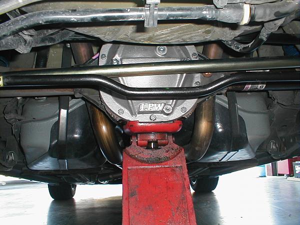

all you need is a better diff cover.
Attached Thumbnails Best placement for Jackstands fnt/back?-p1010059.jpg

Actually, Ford has done a minor re-design on the cover and the lower lip does not extend down as far as it used to (looks like it was just cut off) so there is lees chance of damaging the cover, and no, my '07 doesn't have it either, it seems to have been a job#2 change. Oh, and I agree with what Bill said, jack up on the diff and the K-member where it looks corrugated in the middle.
