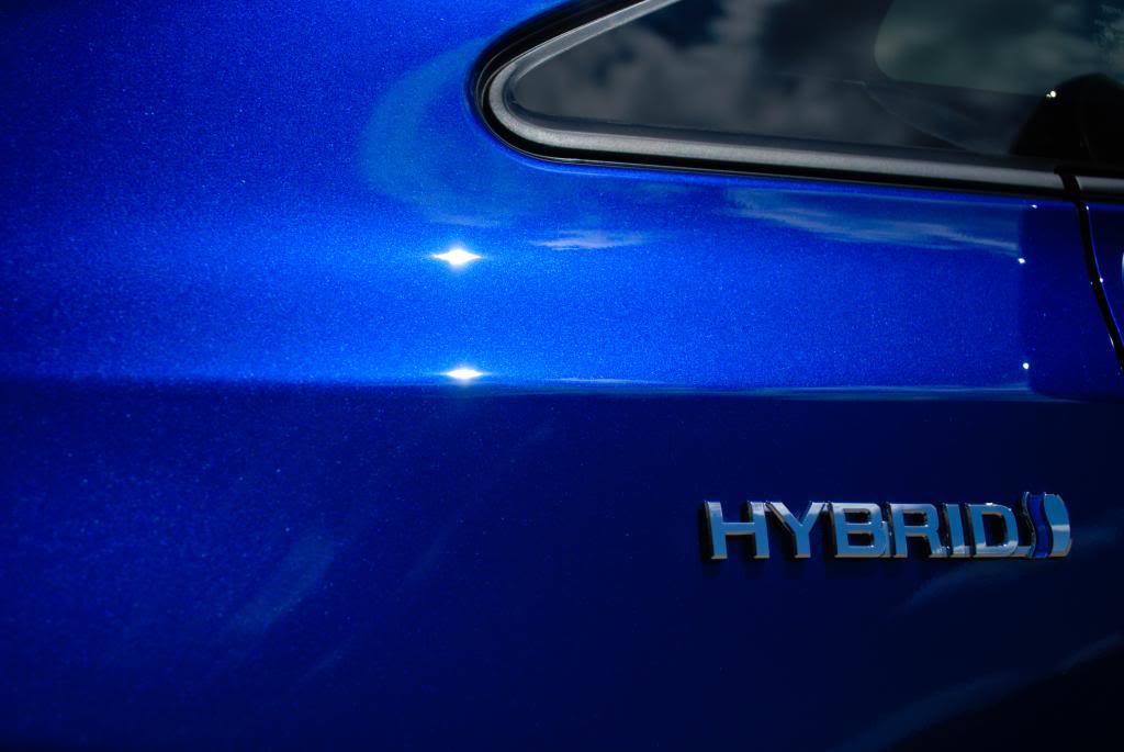

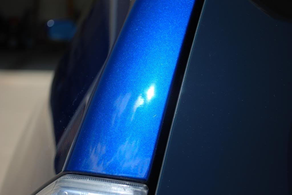

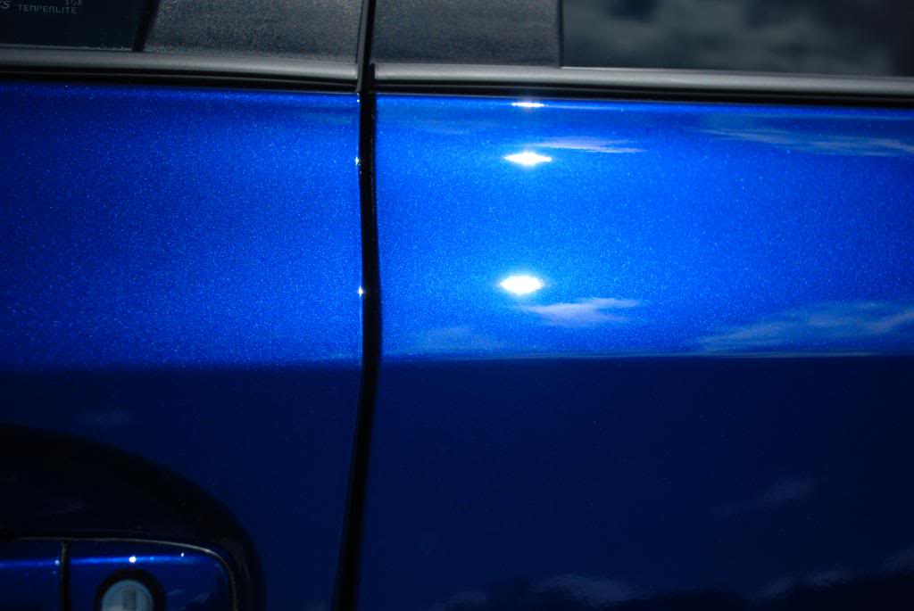

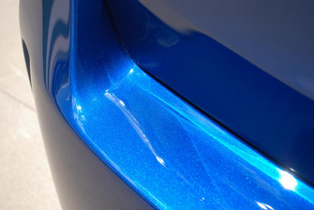

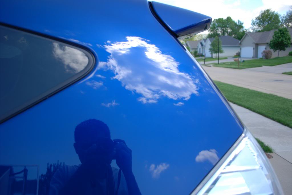

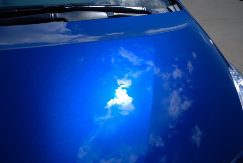

First off, all you Prius haters out there, remember that this is my wife's and just for a moment, close your eyes and pretend it's a mustang (like mine) and focus on the fantastic paint on it hahahahahaha

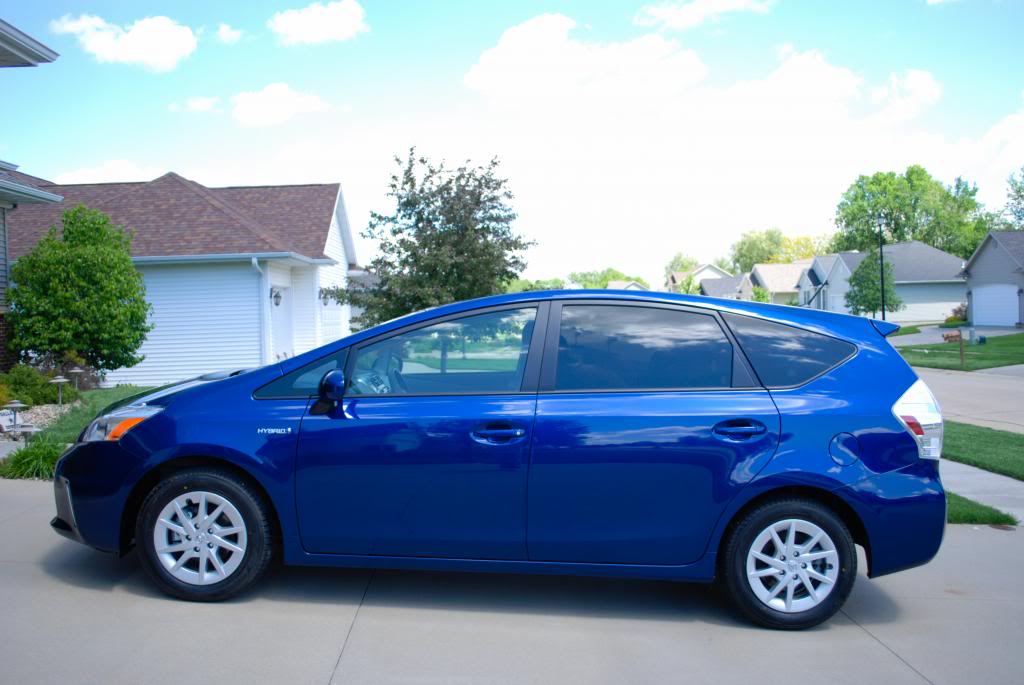

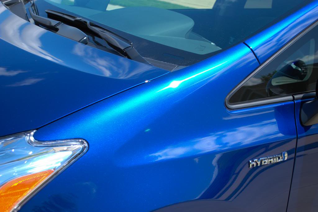

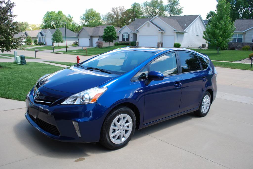

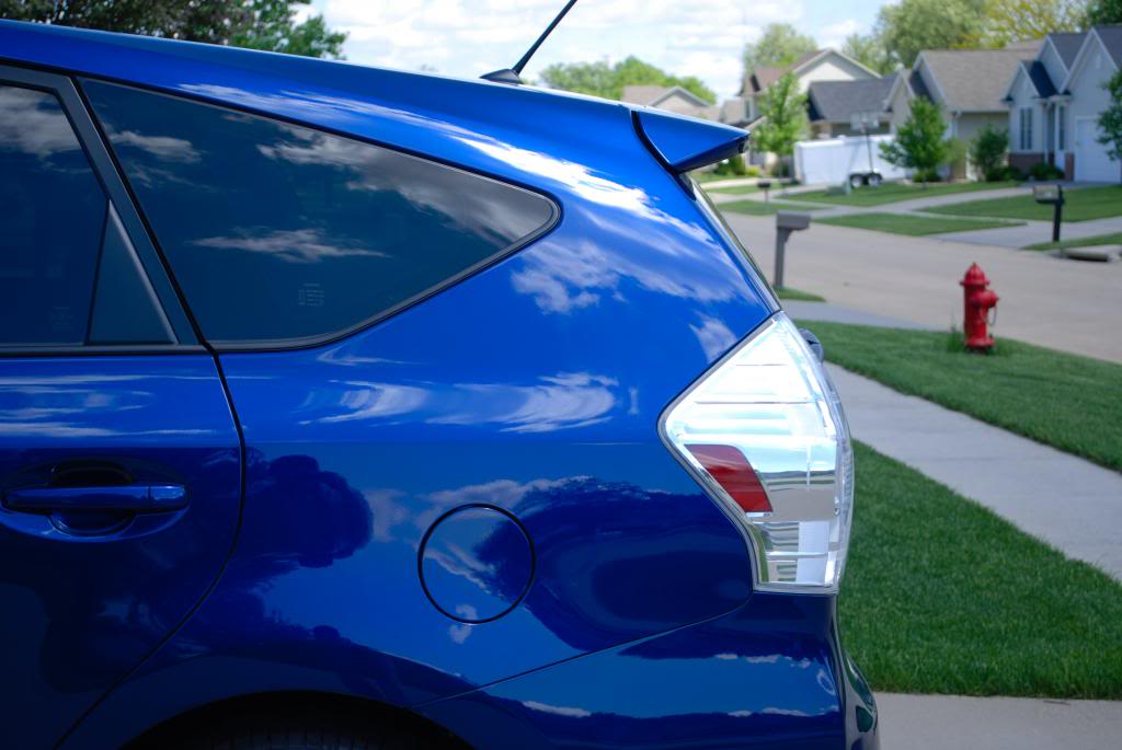

Anyways, finally got a chance to do a full correction on Portia. Dealer had some scratches/swirls on it, but nothing too major. Was only sitting on lot for a couple of months, but amazing what dumb dealer detailers can do to a car.
My process was as follows:
1) Wash/dry - 2 bucket grit guard, with lambskin mitts, then
  • Chemical Guys (CG) Honeydew
  • Optimum No Rinse (ONR)
  • wheels cleaned with Optimum Power Clean/Daytona and boars brush
and dried with CG V7, and leaf blower
2) Clayed with Sonax clay (this stuff is just "ok"... a little bit harder than pinnacle clay. Left some minor marring.)
3) Using Flex 3401, corrected with white CCS pad using Menzerna Power Finish
4) then gray CCS pad using Menz Super Finish
5) then applied CG Blacklight
6) then applied 4Star Ultimate Paint Protection (UPP)
7) then applied Dodo Juice Supernatural.
Overall time invested, 10 hours.
Here are the results. MARCHARRIS, let me know your thoughts too sir.
Enjoy.

Very nice work, color really pops.

It looks good...
...but...
It's going to look better after the first wash believe it or not. Take more pics in a week after you've given her one gentle bath, and look at the clarity of the finish then
Supernatural always looks better after a wash: especially if it's put on over another product (like blacklight let alone blcklight and UPP).
Don't get me wrong: she looks AMAZING!
In a week after a wash, she'll give you the result I like to refer to as "Photoshopped in real life" when you look at it.

Thanks very much guys. I agree about the color. How does it compare to kona and DIB? Hmmm it's lighter than DIB, and with no red flakes, but still metallic.
Originally Posted by MarcHarris
It looks good...
...but...
Marc, I appreciate the kind words. I will have to do a report back after she gets washed. It's actually raining today, so will get to wash it this weekend.
