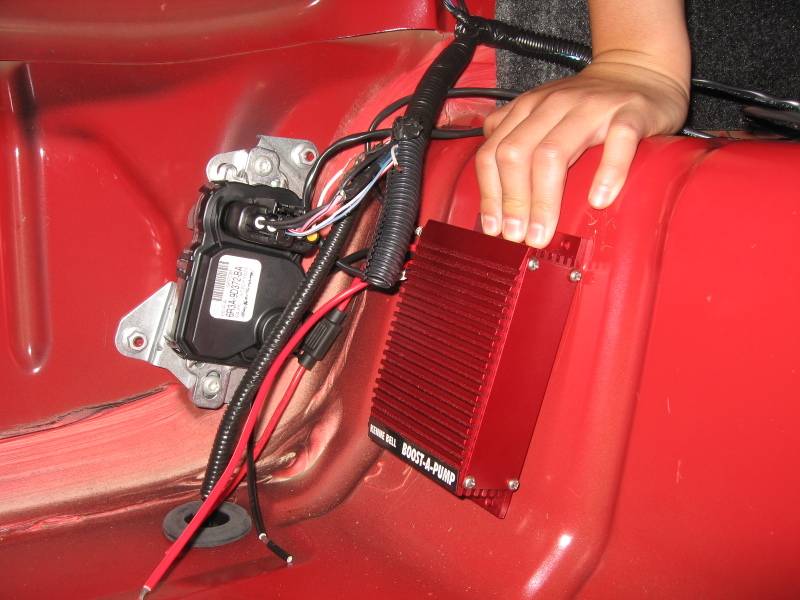

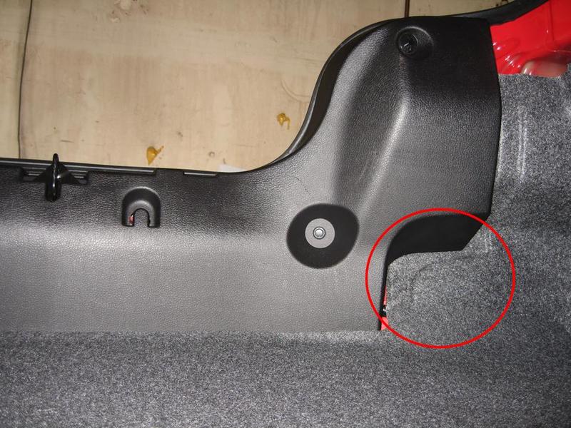

BAP install update...
Trying to figure out where I want this thing mounted.
Here's where KB tells you to mount it in their SC install manual. Problem is, it pooches the rear plastic panel out near the bottom. Locating it slightly outboard will work, but then the wires won't reach.

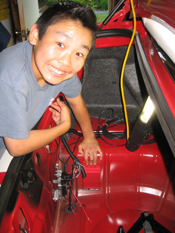

What looks good so far is to mount it in the spare tire well. Plenty of wire length, more ventilation than being covered with the carpet, and won't interfere with the spare if I decide to keep the spare (I'm thinking of going the PJ inflator route).

That looks like a great area to install it Bill, it almost blends in with the color

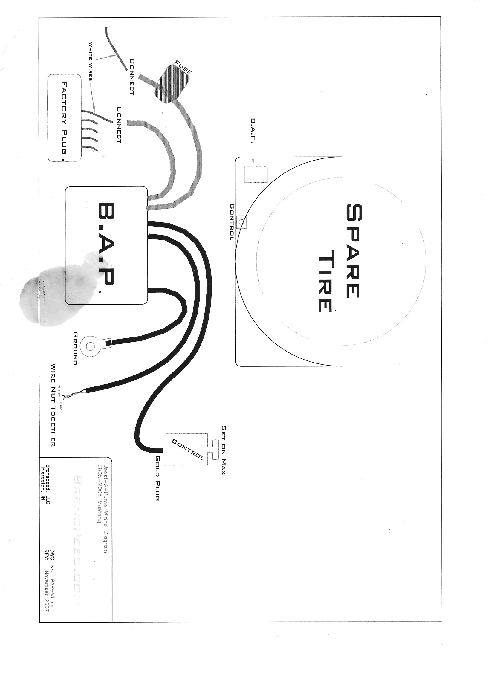

Yeah, I put mine there too, plenty of room with or without the tire. Also once you get it all hooked up if you put your ear up to it you should hear a buzz with the dial all the way at 50. If you can hear the buzz you know it's working. My controler is always set at 50 so once I got it all done I put a piece of electrical tape over the **** so it wouldn't move.

That's the picture diagram I needed 2 weeks ago.
Robbie, did you wire the 2 boost switch wires together like your diagram suggests?
I'm pretty sure I'll be doing it by the book and use the boost switch. Jed's Roush uses the switch and Brenspeed includes it in the kit, but I read lots of guys just bypass it all together.
