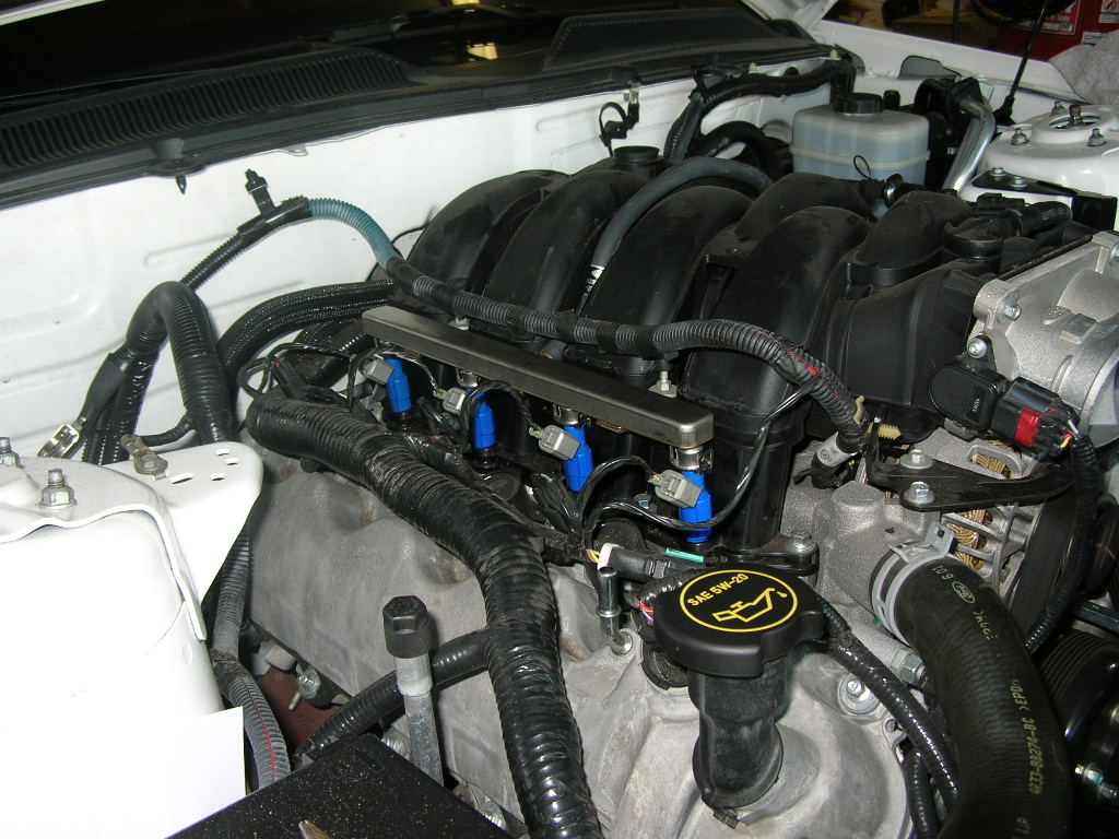

I have 39 pound injectors now, too... blue ones, right?
Your fitting issue will seem minor and no big deal a couple weeks from now. At least you know the problem. My biggest issue was trying to figure out what was wrong.
Yup, same blue FRPP 39# Cobra injectors.

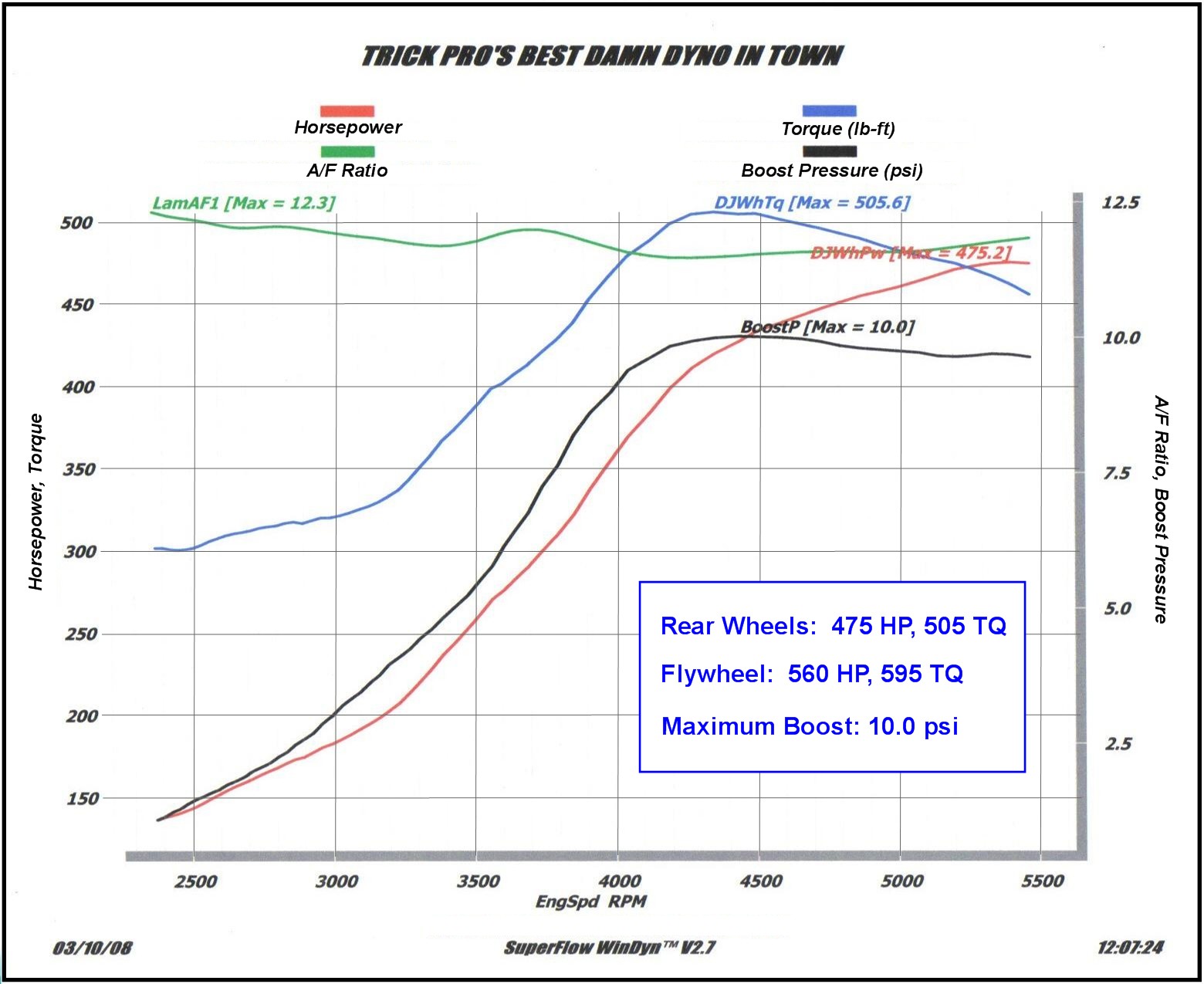

No fuel starvation:
Never gets leaner than 12:1... mostly around 11.5:1 through the entire RPM range.
At 4200 it technically starts to get leaner... but not what I would consider a "lean condition" by any means.

No fuel starvation:
Man, I don't get it..
I don't doubt you dyno chart one bit, I just don't understand when larger pumps or BAPs are needed. Theoretically, I know I can drive all day at less than 80-90% throttle without a BAP, just not sure what'll happen when I drop the hammer. Guess that's what my Stoich A/F gauge is for.
I don't get it either... they want more of your money??
I can drive 60 miles round trip to work and never even pressurize the engine! But that chart was definitely showing the hammer dropped:
http://s47.photobucket.com/albums/f1...t=DSCN6854.flv
We verified A/F ratio on the Predator and it was always around 11.7:1 on the street at WOT.
