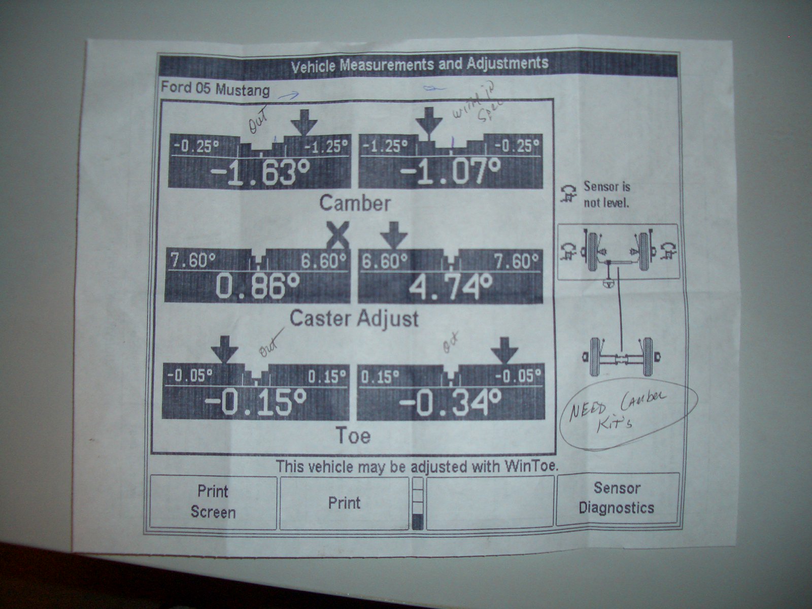

Well,it seems I need camber bolts. Here is the spec sheet. The caps were taken care of fine.(No damage). heres the real kicker..I also need a panhard bar . I do not have the equipment to do this job myself ,have any friends that do,or really care to mess w/ loaded springs.. The labor was 2 hrs(150.00). I know(could me more mods) but oh well..I need Leo's awesome research skills to search for lowest price on panhard bar and camber bolts(if he doesn't already know)..The ride seemed a little more harsh(don't know if thats because of the pigeon toed wheels) I will get tokikos soon...This lowering is costing me an arm and a freakin leg
I'd like to check that camber with my digital angle finder. Mine were practically perfect without the camber bolts.
You do have the equipment to tie two nuts to strings and tape the string on the fenderwell above the rear wheels. Let the end with the nut dangle over by the center cap. Measure from the string to the edge of the rim lip on both sides. You only have to move the axle HALF of the difference to correct it. Tell me what your difference is before spending the money on a panhard bar.

How far off is your rear that you need/want an adj pandhard??? I know mine is off ever so slightly but I don't think it's enough to justify the price of a new panhard. I think your alignment guys a liar. Reason being I've never heard of anyone with ultralites ever needing the camber bolts.

I think Bill's got some camber bolts he's been trying to get rid of. Send him a PM to see how much he'll sell them to you for.
Old May 2, 2007 | 05:07 PM
  #8569
I do have a brand new set of Eibach camber bolts. I can for sure work something out with Chuck, that's not a problem.
Question is, if he really needs them despite what his printout says.

Camber bolts will be required if he wants to shoot for 0 degees. Otherwise, remind him that Ford's tolerance goes up to -1.5 degrees.
Who would want it at 0°? There is no way that you should NOT be able to get it between -.75° and -1.5° with the stock bolts. As a daily driver, though, you would want it closer to the ideal factory setting of -.75°. (Mine are -.8° without the camber bolts).
I still don't like the thought of 12mm bolts on the spindle when the stock ones are 14mm. Heck, I changed mine to 9/16" bolts (14.23mm). You can only torque a 12mm 10.9 bolt 85 lb-ft versus 135 lb-ft for a 14mm 10.9 bolt.

It took forever for you guys to respond...what the hell are you doing? eating dinner or something I can see the rear w/ the naked eye and it is off pretty bad. The camber issue ..well I don't know how to measure that my self.The guy is not going to charge me to install camber adjusters,so I don't think he's lying.

The ones he has are the ones you want... but don't hit too many bumps with those wimpy 12mm bolts, or take corners too hard, or do anything to put any undue stress on them.
Well, I didn't mean 0° per say, just a neutral setting.
I can't see how it's off that much versus the other side.
