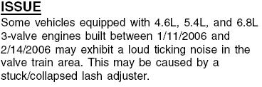

TSB-06-9-11
3-valve lash adjuster
Old Apr 1, 2007 | 11:06 PM
  #7683
Let's see... I just started noticing it a little while ago, so maybe 9000-9500?
Wonder what would happen if I added 5 more ounces of friction modifier.
We are both in this window, too:
TSB-06-9-11
9k miles? Wow, I'll probably find another excuse for the gears way before then.
Adding 5 more is a good idea, if there's room.
I doubt we're part of that TSB. Attachment 23071
Our cars were built within a couple weeks of that date range of affected engines. I'm betting our engines were built way before that and were just sitting in crates until they were ready to be installed.
Oh yes... ENGINES built in that window, not cars... good.
