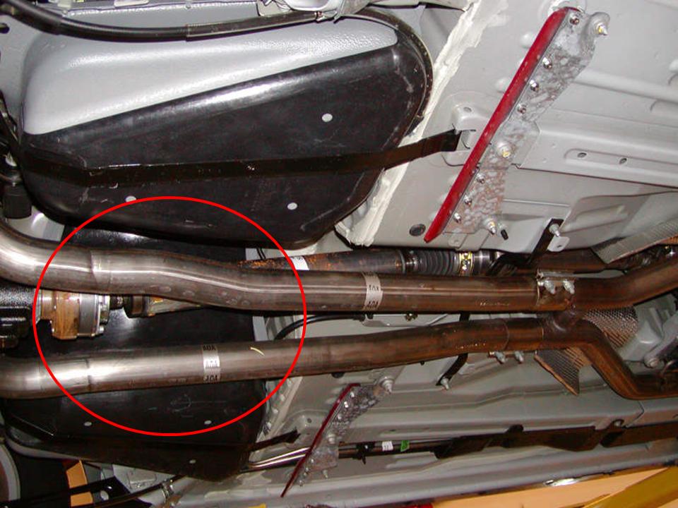

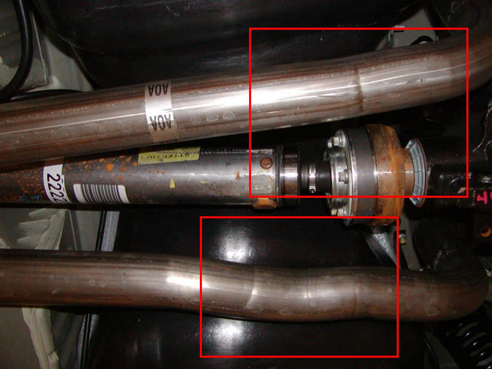

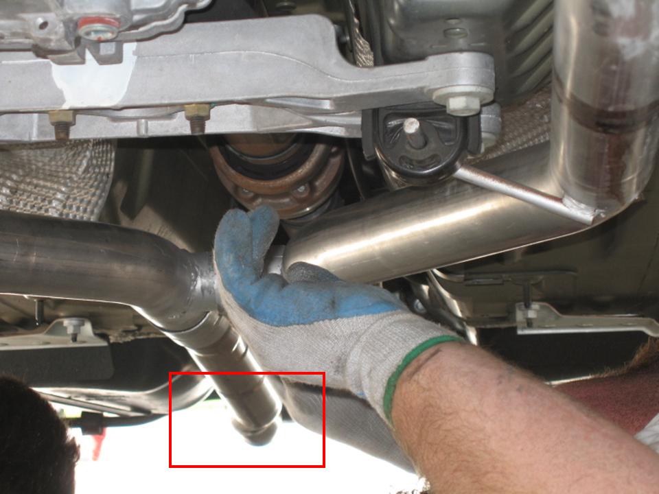

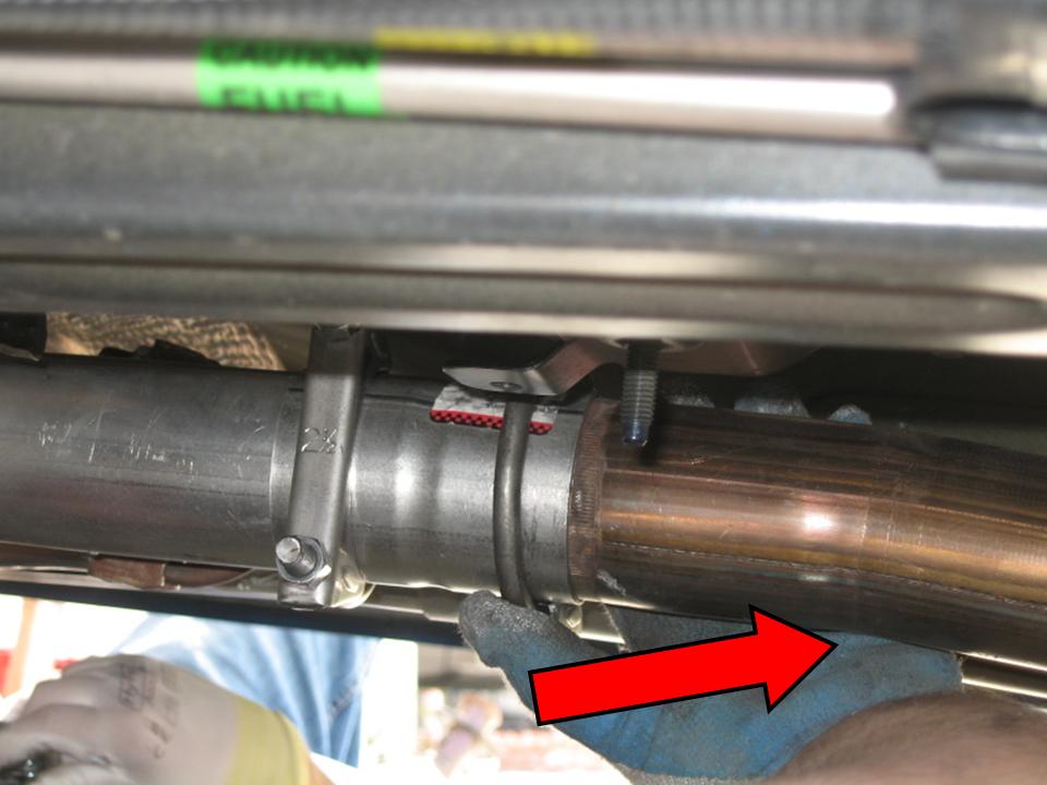

Oh... I definitely need the Ford or whoever exhaust clamps, I think I have a leak and the pipes drag over the driveway into my parking area... I know we pulled the mid pipes to get the tips in further but I don't believe we pushed them up towards the undercarriage before we tightened them down. It's something to do on Friday after work....

Funny (well, maybe not to you), but remember when Leo and I mentioned that at Ruby's? When we were following you, we could see the rear section of the H hanging down pretty low and wondered if our cars did the same. We also thought that since you have the FRPP srpings (versus our Ultralites) that maybe that too was a contributing factor.
Another thing Leo and I talked about is that the hanger rods (on the H) are fixed. Meaning the low point of the pipes must be aft of that section. Here's some pics of your car compared to a couple stock file photos. Take note of the highlighted areas. I'm betting that you have a rotational issue on the rear pipes and that the over-axle clamps are also out of adjustment (possible cause of not being able to move the tips further back into the bumper cutouts).
Attachment 22587 Attachment 22588 Attachment 22589 Attachment 22590
To correct this problem, I would get the Ford clamps and break down everything from the midpipe clamps BACK. Don't loosen the manifold connections. With the Ford clamps in place, adjust pipe rotation and tip placement.

For your exhaust situation, I would save those 2.5" connector clamps you just got and use them on the H section you cut out (assuming you get replacement Ford clamps for the midpipe).
