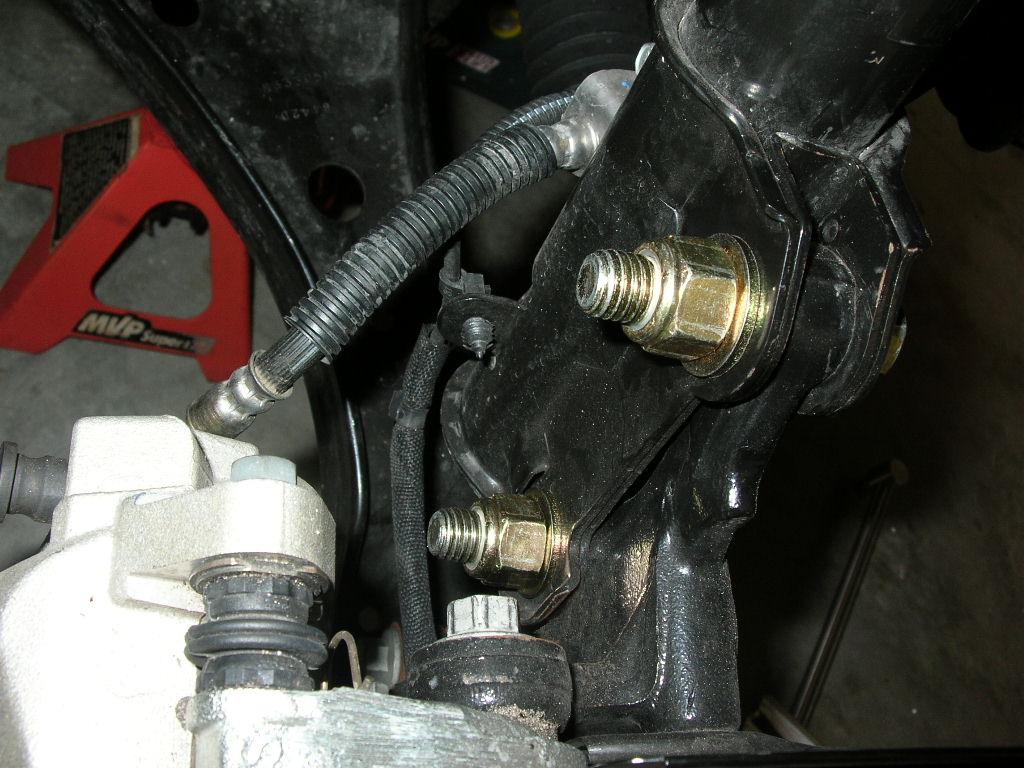

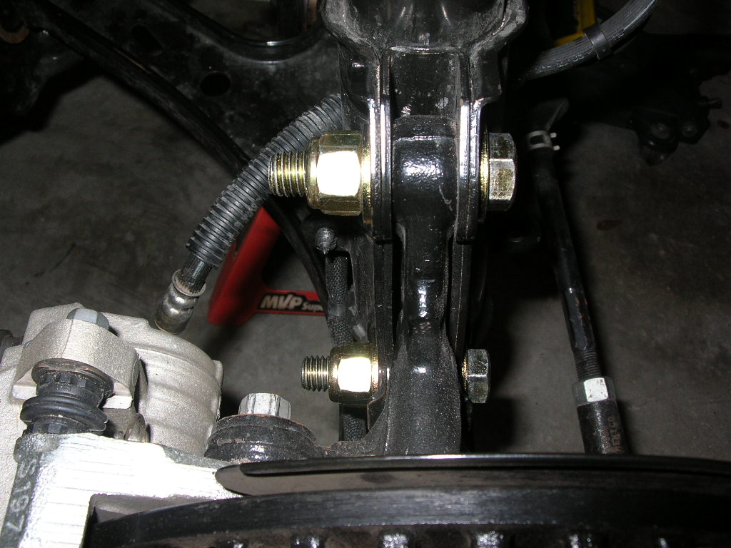

One thing that has been bothering me for a long time is the bolts that attach the struts to the spindle. There is so much slop in both the upper and lower bolts.
So, I finally ordered 9/16" bolts, washers, and lock nuts. All are Grade 8 hardware. The factory bolts are 14mm and 9/16" converts to 14.2875mm. I figured with the little bit extra it would take up more of the slack.
I was right. The bolts slipped right into the strut holes and needed to be lightly tapped through the spindles. When both the upper and lower bolts were in and tapped all the way through, the slop is practically non-existant.
Now I know both sides of the car are identical and I can make small camber adjustments up top where the strut attaches to the strut towers.
In fact, I used a lug nut to hold the rotor tight on the spindle on both sides (with the tire off). Then, I measured from the strut body to the edge of the rotor. This distance changes with the slop in the strut-to-spindle bolts up to 1/4". Now, both distances are identical down to 1/32".
Also, with 9/16" Grade 8 bolts, they can be torqued to 184 lb-ft, so the factory torque of 148 lb-ft needed on the 14mm bolts is no problem (I put 160 lb-ft on all 4 bolts).
I'll take pics of the new pretty bolts tomorrow morning. Then, when I get the tires back on and drive around the block a few times, I'll take a camber measurement before I touch the upper 4 nuts at the strut tower to see what my camber is.

One thing that has been bothering me for a long time is the bolts that attach the struts to the spindle. There is so much slop in both the upper and lower bolts...
Yes, I agree hat there's a lot of slop there, but it's there for adjustability.
Even the stock 14mm bolts, once camber is set and torqued down, it ain't going anywhere.
No, it's not. It's there so they can slap the bolts in at the factory. They throw the bolts in the holes and torque them down without even checking the camber. The proper camber is built into the car. It may be different from side to side, but it's still within the window for camber.
For adjustability (once lowered), you are supposed to elongate the upper holes in the strut so you can pull the top of the rotor out more. The camber bolts are just an easy way around that, but I don't like the 75 lb-ft max torque on those bolts when factory is supposed to be 148 lb-ft. That's why I took them out.
For our Ultra Lite springs, we could just slap the stock bolts back in and camber would still be in the window (you saw that for yourself).
I did this for piece of mind - now I know each side is identical, within the camber window, and will never move.
Here are some pics:
Attachment 16690
Are the proper amount of threads showing, inspector?
Attachment 16691
