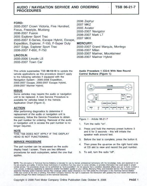

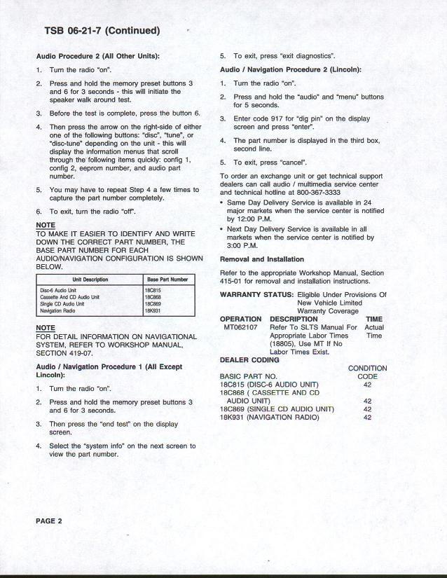

Also You Can Pull Your Own Radio Numbers if Radio Still Functioning By Following This!
