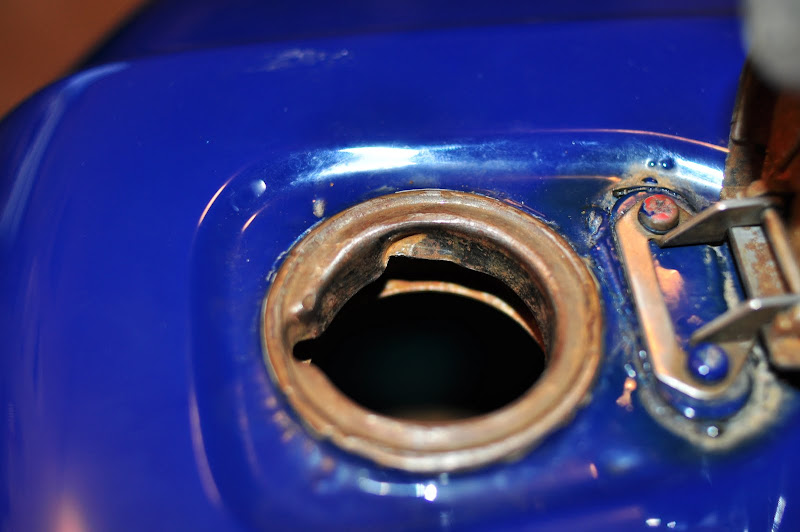

And the latest step is on the gas tank. The gas cap leaks...badly. If I ever laid the bike down at speed and metal sparks on pavement with all that gas flowing out...well, that'd at least be the end of the bike at least. I've been on some motorcycle forums trying to find solutions to it, but I haven't had a whole lotta luck. There have been some good tips, and the best one yet is to get some rubber gasket material and make my own gasket. I've been looking locally for gasket materials, not much luck.
So I've been trying to find another way around it, and here's what I've been learning. I got this stuff called "Seal All" which I was able to repair the tear that was in the gasket (my suspected leak), but the problem isn't necessarily the seal, it's that the cap isn't being held closed enough to keep the gasket seated on the tank.
Starting out:
At first inspection, the metal is bent around the filler hole in the tank, and after some quality time with a hammer, some wrenches, and a hole saw I've been mostly successful with flattening it back out (and have gotten it to sit much better), but there's only so much I can do and it's still leaking. The easiest thing to do short of finding a better tank is to just build up the gasket to be taller with some rubber that's fuel resistant.
I've posted this on bike forums too, but I'm not holding out for much of an answer. That said, I know my fellow 'Stangers here are a **** resourceful bunch. Does anyone know where I can find said material? Advance auto parts only has Felpro mats that are rubber-fiber. Like rubbery cereal box cardboard. I need something much more pliant, softer than that stuff. Thanks !

Any idea on exactly how thick it needs to be?

Ummm I got something you can try if you want rubber. It is prolly really easy to get it too. How bout trying a innertube?

Doesn't need to be very thick, probably could get away with 1/32".
Will inner tube be resistant to gasoline?

Yes inner tube will be resistant to gasoline
If you want you can try a lil experiment by putting a small piece in a cup of gas and see if it will disolved.

If I understand what you are saying, you feel that you have the tank pretty well repaired. If that is the case you can get a new filler cap for $70, this should include a new seal. I don't know what your budget is for the repair but it could be an option. Only down side is you will have two keys for the bike. By getting the new cap you eliminate and possibility of the cap also being bent causing a poor seal.

While I"m all for figuring out a solution that's somewhat unique... I don't think you're ever going to get a really good seal on it.

Well, anyway, I'd recommend replacement on the tank. Fix it right, IMO. But, if you go with the rubber material, good luck, I'm sure you'll get it figured out!

07S197, I'm trying to keep my budget pretty low. I've been to Bike Bandit and a couple other online stores, not having much luck. Besides, $70 is pretty steep for a gas cap. My father got the tank off ebay years ago when he still had the bike. It looks like someone tried to pull its gas cap open by brute force on this one (maybe they lost the key? ) which is why the metal is bent. The cap I have is the original one to this sabre, which I'm happy to say never went through that abuse.
