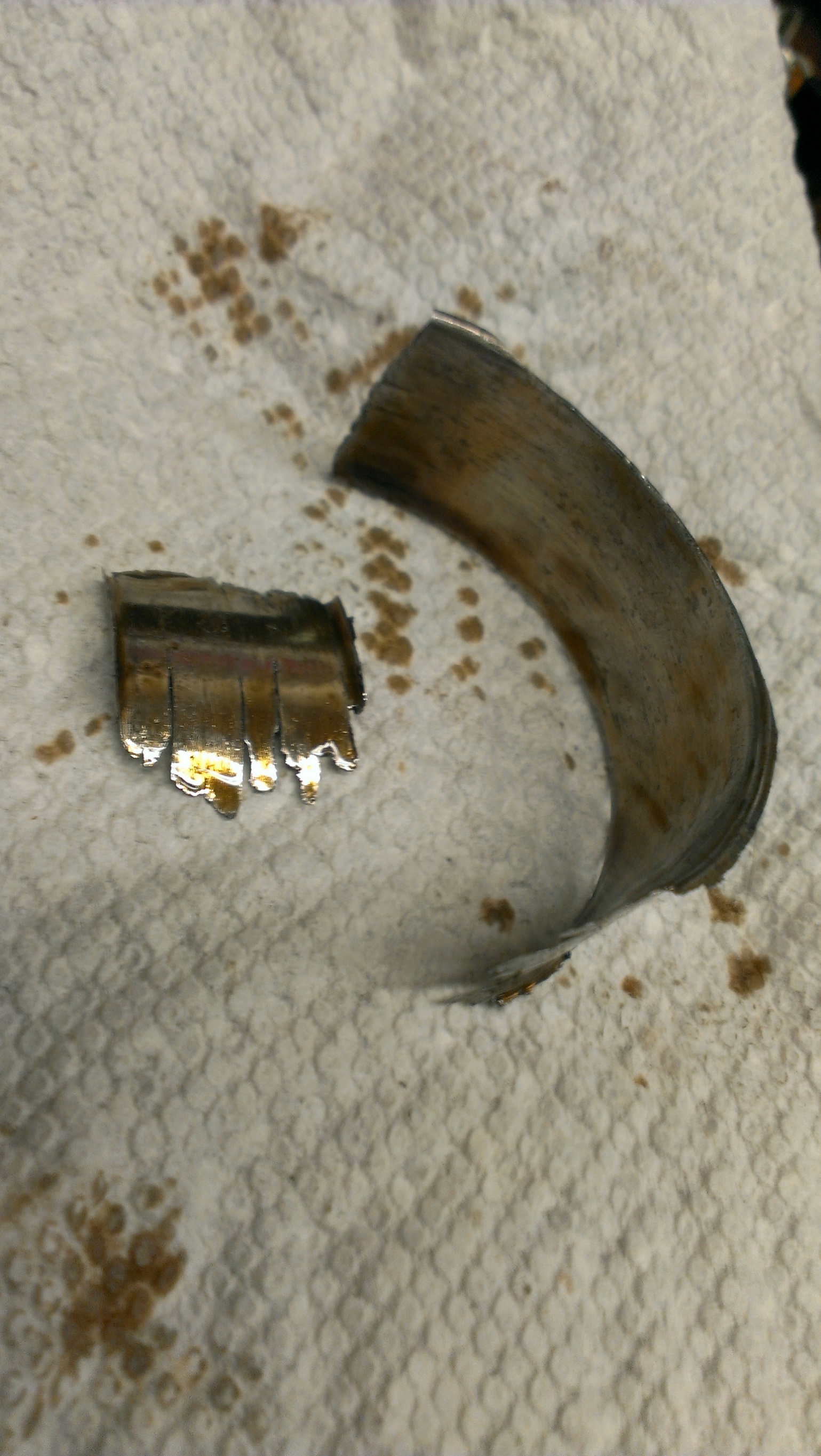

this is what was left of the bearing back cylinder passengers side
Attached Thumbnails I picked up a 2k Grand Cherokee limited-bearing.jpg   I picked up a 2k Grand Cherokee limited-bearing2.jpg
Old Mar 17, 2014 | 11:05 AM
spun... I had to fix one of those on my Olds 442.
Old Mar 17, 2014 | 12:53 PM
yep my 2k was in about the same shape. Have the crank turned, replace the connecting rod and and all bearings. Check the specs on the cams, lap the valves and replace the seals. Bingo bango git er dun
