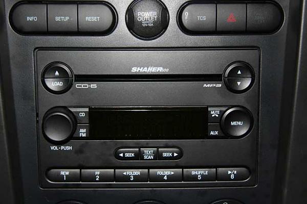

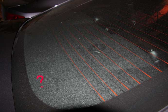

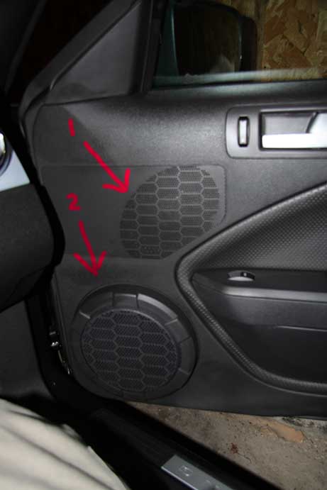

Where are all 8 of the speakers located in our cars with the Shaker 500???
I definitely have the Shaker 500 head unit, and I see the two speakers on each door (making 4 total so far), and NOTHING in the back??? Did I get ripped off??

Ford is counting 3 speakers in each door (the large woofer in the lower part and both a midrange and tweeter in the upper section) and the 2 in the rear shelf.

barjon is correct, You cant see them but they are in there look underneth the rear shelf, either crawl into the trunk from the rear or open the seats and poke your head up there thats where you will see the speakers

The obvious ones are the Subwoofers in the front doors.
Above those you have 3 way speakers in each door
2 more speakers on the rear parcel shelf behind the headrests if it's a Coupe, otherwise they're below the rear quarter panel windows

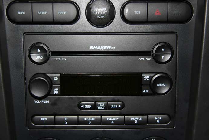

Okay,

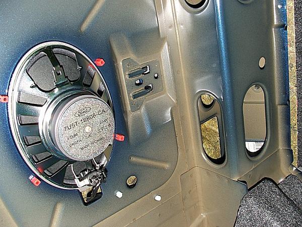

Pop your trunk and look right under the rear panel with the child seat anchors. You should see 2 speakers.

Ford has been doing that for at least 26 years. The speaker cone faces the interior cabin through grilles in the rear deck, but the magnet and wiring harness is actually accessed through the trunk.

Here is a pic of the two front component speakers in the doors:

Here's a pic of one of the rear speakers in the trunk.

They eliminated the rear speaker grills on the 07s. The speakers are under the fabric. Look in the trunk and you'll see the other two speakers facing up toward to rear window.

Yep, you can see the 2007 rear speaker in my photograph... The finest Chinese 25W/4ohm speakers that Ford could buy.

What do you mean? As your picture shows, they are bottom mount. I haven't really looked at them, but shouldn't they just drop down .
