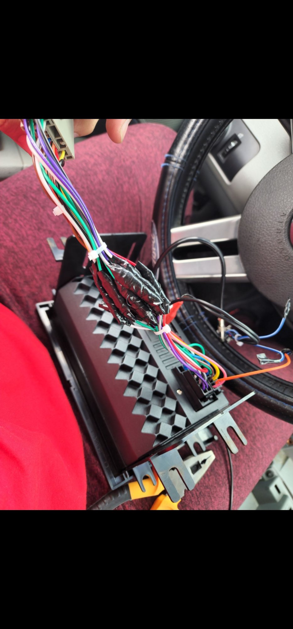

Hello, I bought a stereo for my 2007 mustang and installed it, but I noticed that the subwoofers were not working, I clarify that the amplifier and subwoofers are from the factory. I already bought the 12v to 5v voltage regulator but I don't know where to connect them (it's a shaker 500)
