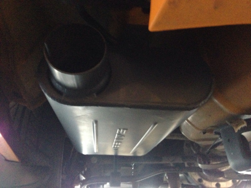

Just ordered up some Saleen Heritage mufflers. They are super cheap on ebay, so I took a risk and "won" them. $98.00 after shipping. For that price I thought why not give em a try. I've searched the net and couldn't really find out much about them. Originally used by SALEEN on S302 Parnelli Jones and Heritage versions. Never found any sound clips so after I install them I'll put up a sound clip.

Welp, I got them today and installed them.... Uhhh LOUD. I knew I was taking a gamble on them. So now I have some questions. They don't come with tips and the mufflers stop about 4 inches from the bumper, could that be causing some drone in the car? It is a bit much from 1500K to 2500K on the RPM's. Will they get a bit quieter over time? Or do mufflers get louder after they get broken in? And my final question, will adding "glass packs" or resonators hush it up a bit? Thanks. I'm gonna try and post a vid in a couple of minutes.

We're they new or used? We need a pic because my guess is that they are not stuffed with material that breaks down over time. If they are loud from the get go than the sound will remain constant.
My guess as they are rebadged Magnaflows. Saleen has no problem stamping their logo on parts they technically didn't manufacture.

They are new and I'm NOT saying they sound bad... actually I think they sound killer it's just a tad bit loud for me. CLICK on my car for the vid with how they sound. You can't really tell from the video it's really when I'm driving the sounds just fill up the cabin.

Oh ok. Those are standard on the Parnelli Jones, Dan Gurney heritage edition and some supercharged cars. Those are originally manufactured by Edelbrock exclusively for Saleen.
They are meant to rumble and with no vibration absorber, I imagine they do!
Good news. They will stay the same in sound over time. Almost every muffler out there drones somewhere in the power band. You got a good set that will take some getting used to. Most people will agree it sounds awesome. You just need to configure some tips now.

OK OK OK OK.... Let me just say that this is my first day on the job and I deserve to be flamed. BUT this post might help some other NON-thinker such as myself So this is how I fixed the DRONE. I added tips to the mufflers. YES thats all I had to do. No glass packs, no sound chambers, no double loop sound wave canceling anti-vibration special service hanger clamps. JUST TIPS. The mufflers came without tips and I didn't think much of it. Then I did think and thought, Wow all the deep sound waves are shooting right under the rear bumper. I didn't want to order tips and wait so I ran to NAPA and got the cheapest tips I could find and what do you know? That fixed the whole thing. Now I can order some nice quality tips from Summit and enjoy the beautiful sound of my 4.6. The Salleen mufflers have an awesome DEEP growl. I also like the "backfire" kinda sound I get when I let off the gas. I highly recommend them, and for a price of 98 bucks shipped to my door I say you can't beat it.
