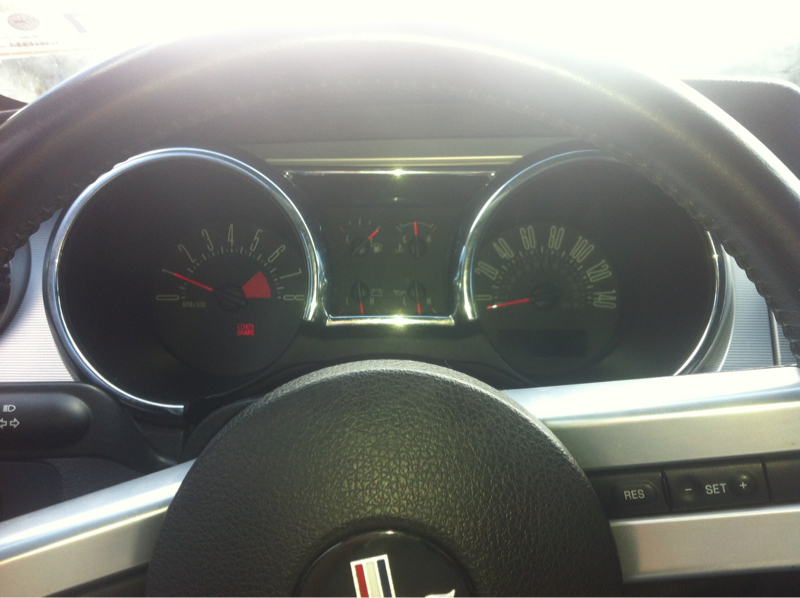

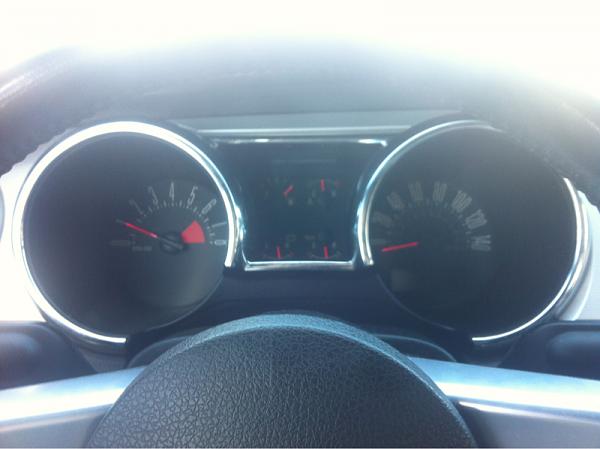

Ok, I've attached two photos, they are the same, but with different lighting for who ever needs help looking at them. But, my tach doesn't work at all, and my speedometer lags so freaking much! And sometimes, like in the picture, I will be sitting there and it is under the zero mph. I will get all the way into 4th gear before it goes over zero. Does anyone know what I can do? I've been told maybe a loose wire(where exactly would that wire be?), that I need to replace the whole cluster, that I need I replace the needle motor, or just buy a new car(hilarious). Sorry for the long post, but I need some help, on a college budget.

In all seriousness, i would think its more likely a loose wire, because if a motor died or the cluster went bad nothing would light up and it wouldn't move at all. Unfortunately I don't have much knowledge this one. Did you try searching the forums? Because I know I have seen plenty of threads on this board as well as others about electrical issues and fixes. The answer may already be out there. I'm sure someone else can chime in as there have been a few members who ran into similar issues over the past year or two

don't know where you live, but do a search on Memphis craiglist for mustang gauge repairs under auto parts. this place repairs all the gauges and give a lifetime warranty, something with the stepper motors i believe. if nothing else call them and ask what would cause this so you will need to find a fix. i will try to look their phone number and post back.
Thanks! This does help! I will give a call, unfortunately I'm in Texas, but you never know if they will receive a shipment.
