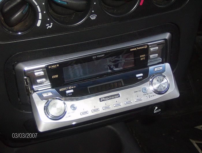

Thnx. I figured about the harness because I use one for ever car I install head units in. I was just curious about little features I didn't know about. For example, the one you stated about the auto volume adjustment.
Once again thank you. Im double thinking about swapping heads now. I have a really nice head unit.
