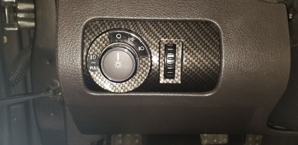

I have always liked the premium carbon fiber dash from my 07 V6 and wanted to add it to my 06 GT. So I bought some carbon fiber wrap and wrapped my dash. I was content with it for a while until I found the premium carbon fiber cluster cover in a junkyard one day and the airbag cover but that one was damaged. So I went on a hunt to find the rest of the dash panels online...
Now get this... I found some for a decent price and they were from my old 07 V6!!! I couldnt believe it! I was so excited that I found my old car. I have always wondered what happen to Beast I. An auto salvage yard, a province over, bought it last year and its been sitting there ever since!!!
So I bought the full dash and my GT500 steering wheel (which I was so upset for not keeping it before letting my V6 go) and drove there to pick it up. So now my GT has a part of my V6 in it and I couldn't be happier!!

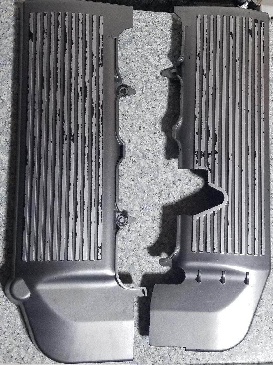

Next I finally was able to buy the missing fuel rail covers and throttle cover to dress up the engine for a decent price. They were a bit beat up and didnt match the main cover, so I had to sand everything and paint them. Not sure what I was doing wrong but when using painters tape to cover up the parts already painted, so I could paint the lines silver, some of the paint would come off with the tape. This was so frustrating since I made sure to prep everything properly before painting and the paint itself isnt cheap!! It was odd...
Here is what it looked like when I got them:
And here are the final results:
Have always wanted this cover. To me it makes the engine look nice.

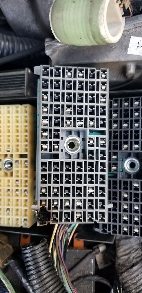

After this I started to work on the battery drain. I was tired of constantly charging the battery and the car dying. I took apart the fuse box to start working on it when I found this:
High speed fan issue! Great something else to fix. Had no idea what to do at the time and couldnt get a replacement since the junkyard here does not have any Mustangs. So one day I took a 2hr trip to some junkyards that had Mustangs only to find out that this part was either the same or missing. Bummed out, I went home, did some more research only to find out other cars use the same box! So I went back to the junkyard and got the same box out of a Pontiac and a Chevy Malibu!!! Got 2 just in case as well as the fan wires from the Malibu cause they are much thicker then the ones in the Mustang! Replaced the box and the pin and I also replaced the 2 fan wires. Hopefully it wont do this any more. I also bout the GT500 upgraded fan that has 7 blades instead of 6. Still need to put that in. So after fixing this issue, I started to work on my batter drain issue. Took a few days to figure it out but I finally managed to get rid of it!
I was SO HAPPY cause it has been over 3 years I have been dealing with this crap. Turned out that it was the EPAS. For whatever reason I connected the power wire from the data harness to fuse 42 (alternator). So I moved it to fuse 43 where when the car is off there is no power at that fuse. My car now sleeps at 0.045 amps which makes me happy!

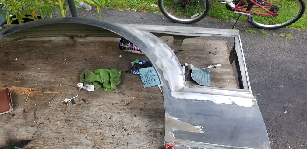

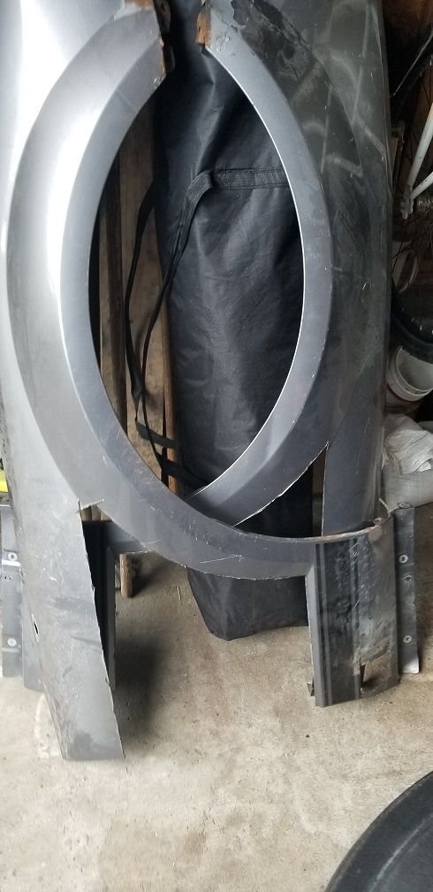

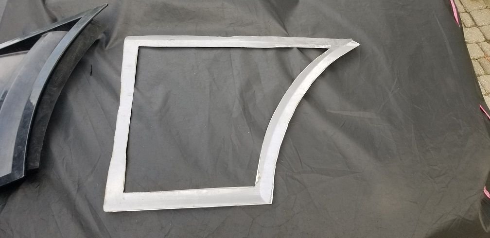

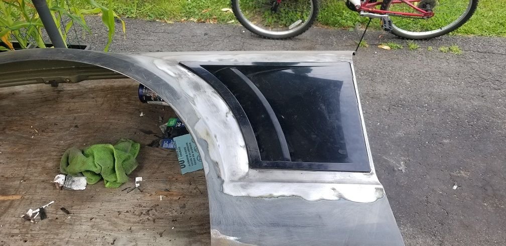

So this summer I FINALLY have some time to do the side vents that I started 2 years ago. The idea here is to make these side fender vents flush with the car, since I do not like the look of it just sitting on top. Kinda looks cheap to me.
I bought 2 extra fenders to cut out some supports for the vents to sit in and then attach these supports to the fender itself. This way the vents will sit almost flush with the fender. Here are some pictures.
These are the extra fenders I bought to cut out the supports.
This is the cutout support so the fender vents will sit in after I attach it to the car.

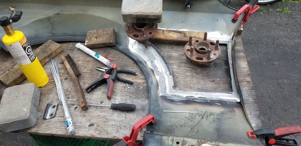

I did not weld the supports. Instead I used some aluminum rods and a torch. Worked out pretty good. I then used something call Metal Glue to cover it for extra protection.
This is what it looks like after attaching the support.

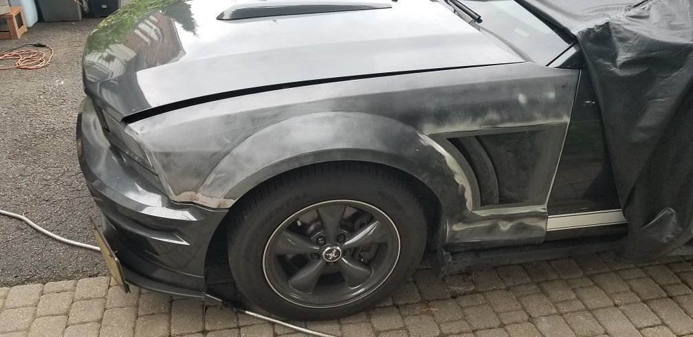

Then glued the fender vent to the support and added body filler after a lot of sanding.
Test fitting it to the car to see what it will look like.
I am in the process of feathering out all the paint so when it is repainted it will look like its part of the car.

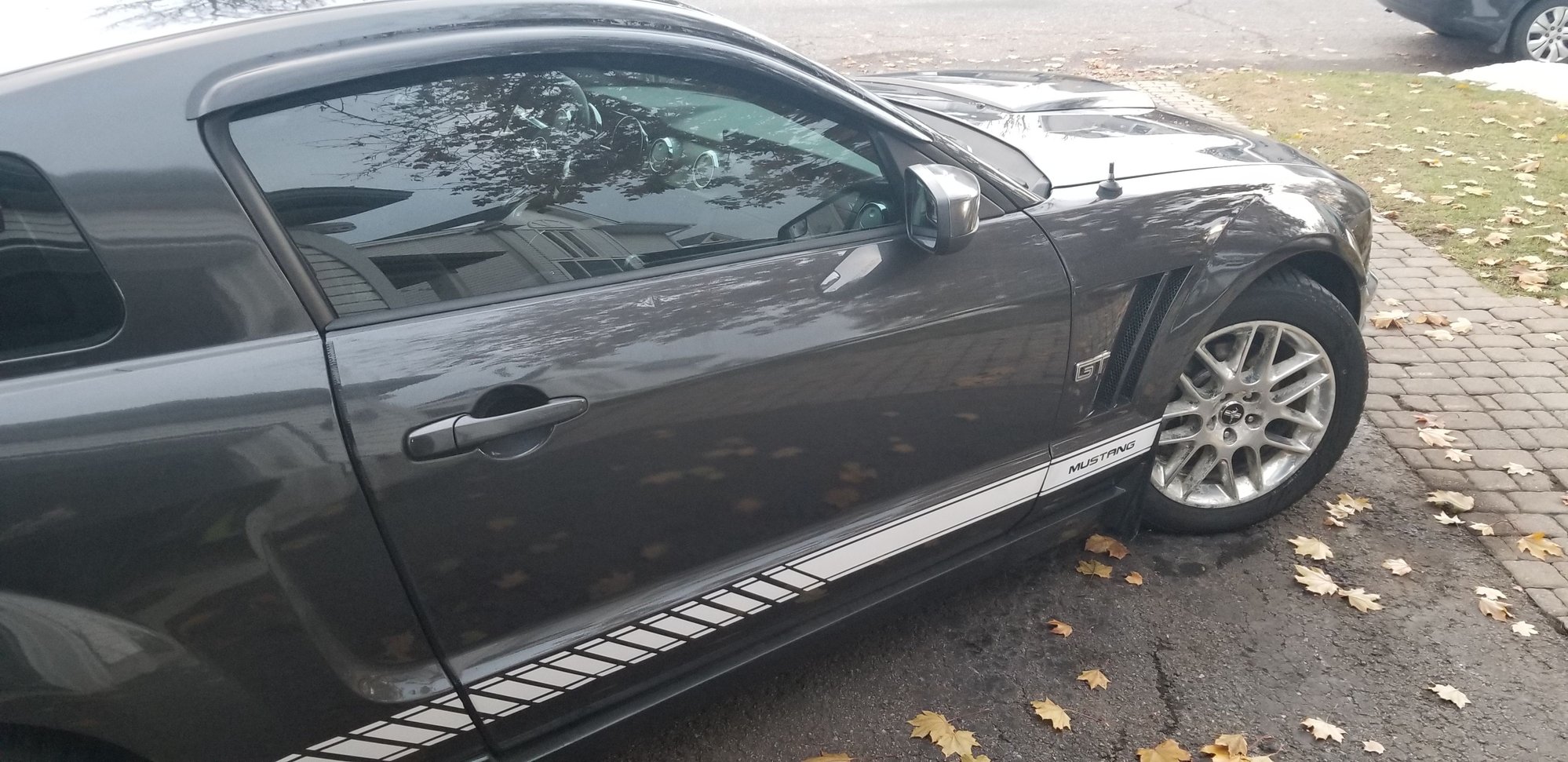

Small update: I brought in my fenders to the body shop back in August to get them painted. Told them to take thier time cause the were very busy at the time. A few weeks go by and I finally get an estimate which wasn't to bad. Two months roll by and still no word from them so I start to call cause its almost November and I wanted to get them on the car before the snow hits.
OSo about 1st or 2nd week of Nov they gave me a call and said they are finally finished. I was so excited.
Got there the next day and they look beautiful. Though they told me to be careful with them cause of I tourque them to much (with speed) they MIGHT develop a hairline crack. Sucks but understandable. Now here is the awful part.
It was raining out that day. So when loading on the fenders into my Cruze (don't judge haha) I managed to scratch one of them cause I wasn't paying attention to the bar in the car that separates the back seats and the trunk. Man I was pissed at myself and the guy was upset too. Scratch was deep too. Just like me to mess it up.
Well got them home, and I filled in the scratch with paint. I'll sand and polish it up next Spring. Should be fine.

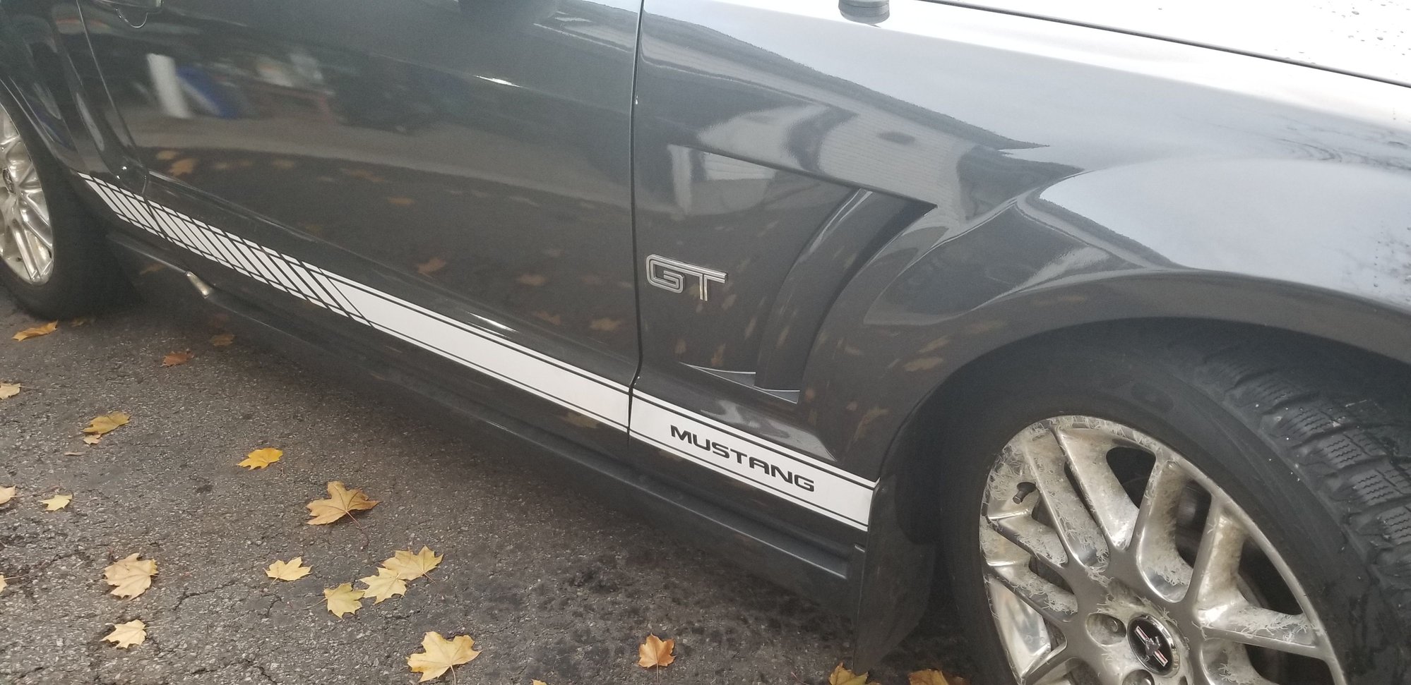

I put on the decals and everything else and put them on the car. They looks so good. Here are some pictures. Please ignore the wheels as they are my winters.
