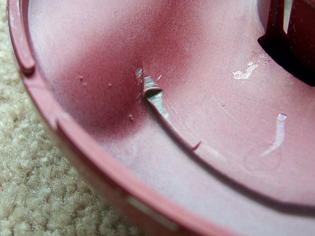

I didn't get any response by email, so I decided to give them a call. I did speak to Helmut. He suggested to look underneath the covers to check for any marks (mine don't seem to be rubbing on the top, just underneath). There was one mark under each of them and he suggested that I either file down the bolts that are hitting them, or as catman said, use a dremel tool on the cover. Not sure what I'm going to do about it yet. I'll have to think about how important they are to me or if I should just return them and put my money toward another mod..........since there always seems to be something else I want!

Sorry it has taken a while to get back to this, it's water skiing season and things have been busy. So I got my new shock tower covers and popped them on, drove the car for a couple of days, popped the hood and the covers were off again!!!! I started looking at the covers to see what was going on and I figured it out. In the center of the cover is a hole where the top stud of the shock goes in, I greased the shock stud to keep it from rusting and noticed that the grease on top of the shock nut was gone. The hole that the top of the shock goes in has a ridge around it about 3/4" high that is hitting the top of the shock nut. When you hit bumps the top shock plate pushes up and pops the cover off. I removed about 1/8" off of this ridge so it does not hit the nut and they have not popped off yet.

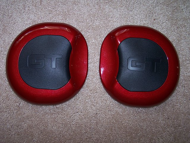

Thanks Terry, I'm glad you have yours fixed. For right now, I just leave them off and put them on if I go to a show or cruise in. They really do look great on the car. Here's a couple of pics of the underside and painted side. I love the paint job on them.
