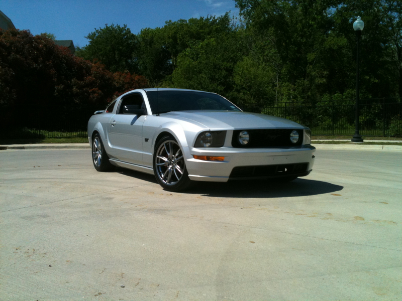

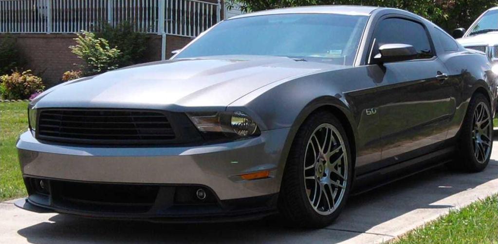

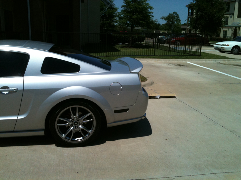

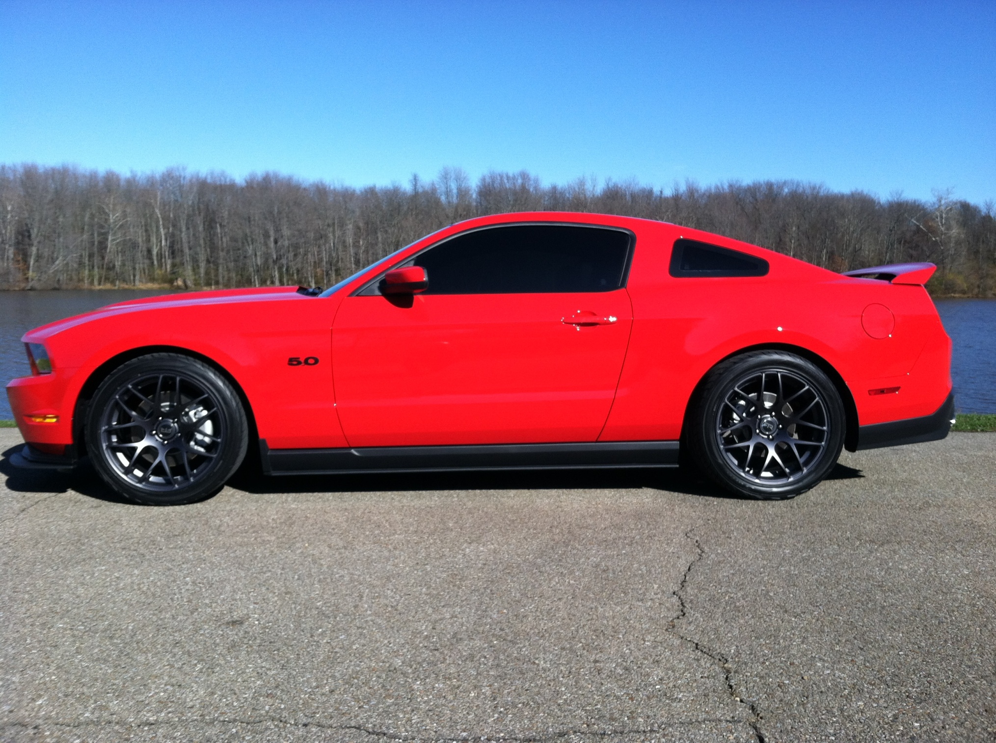

I'm in Ohio, I lowered my car with the steeda ultra-lite springs, I have been through all 3 sizes of wheel/tires. My latest (hopefully last ) set of wheels it the 19". I got the 18" gt500 wheels and the ride was fine but I felt the wheels looked too small, the tires were too short and my spedo was off about 2mph, My next set was FRPP Spyder 20" and I thought they looked too tall with the lowered vehicle, they were also not wide enough (20x8) but I got the same height tire that the factory 19" tires were so my spedo was correct., They are much heavier and i seemed to get less traction. I ended up with the 19' RTR's.
Attached Thumbnails Lowered and 20's ride impact?-dsc07248.jpg   Lowered and 20's ride impact?-img_0707.jpg   Lowered and 20's ride impact?-img_1311.jpg

Second picture with silver rims is better I think.. Reminds me of silver RTR

I dig both the 19's and 20's on your car dwtc, for whatever reason the 18's actually look a bit small for your ride.
