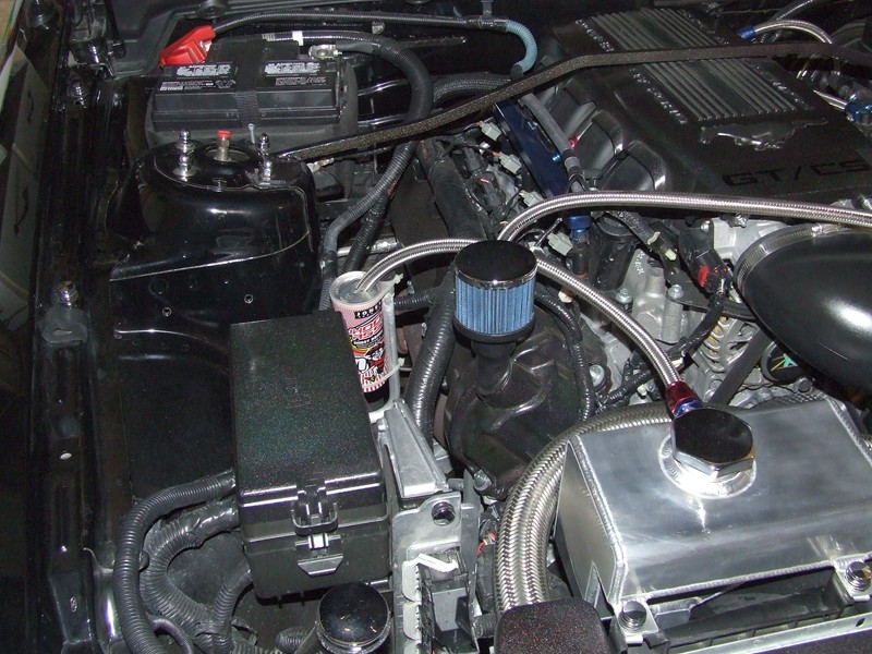

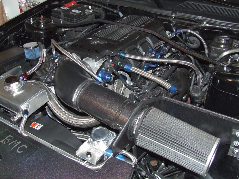

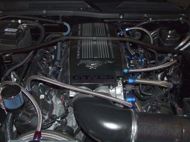

Here's a picture of mine. I'll look for all the correct Line sizes and lengths.
Attachment 30155Attachment 30156Attachment 30157
Attachment 30158Attachment 30159

This a list I found made by member rtleslie.
I got all mine from amstreetrod.com - ask for Jay
Here's the list:
List:
Perform-O-Flex:
# 24 - One hose 12" Blue Anodized Fittings - Econ-O-Fit
Auto-Flex:
# 28 - One hose 16 1/2" - Blue Anodized Fittings - Econ-O-Fit
# 7 - One hose 22" - Blue Anodized Fittings - Econ-O-Fit
- One hose 20" - Blue Anodized Fittings - Econ-O-Fit
- One hose 15" - Blue Anodized Fittings - Econ-O-Fit
- One hose 10" - Blue Anodized Fittings - Econ-O-Fit
# 5 - One hose 12" - Blue Anodized Fittings - Econ-O-Fit
# 11 - One hose 9" - Blue Anodized Fittings - Econ-O-Fit
This for 05/06 GT's, 07 Gt's don't use the #24 hose and you will need a 36" #28 in it's place (Just 1 #28 hose 36" won't need the 16 1/2" one).
Total cost was about $250 I think.
