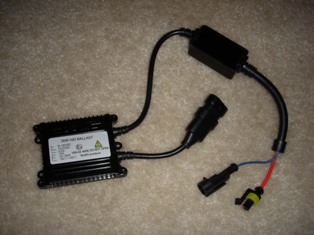

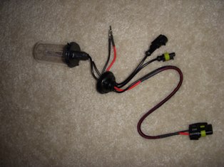

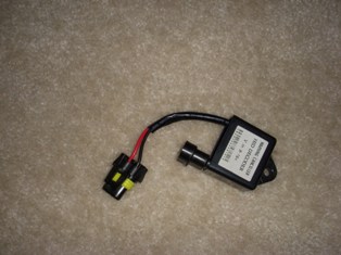

Pics...

I know I sound rediculous but what wire is a ground wire? I called the company and they said nothing about a ground????

I don't have the brand you have but is the black and red wire twisted together on your second pic? I would assume that is power and ground. You should be able to run the red wire to the fuse box (where the battery cable connects) and the black should go on a chassis ground. I used an existing ground point for mine.

The red and black wire with the single prongs are not twisted together, they are separate. They are not very long so how do I go about making the red one reach a power source? The fuse box and battery are obviously on the passenger side so how do I make the driver's side light reach with a 1 foot wire?

From the pictures it looks like PIC1 connects to you headlight plug, picture3 connects to the outlet of pic1. pic2 plug into the pic3 red and blue.
