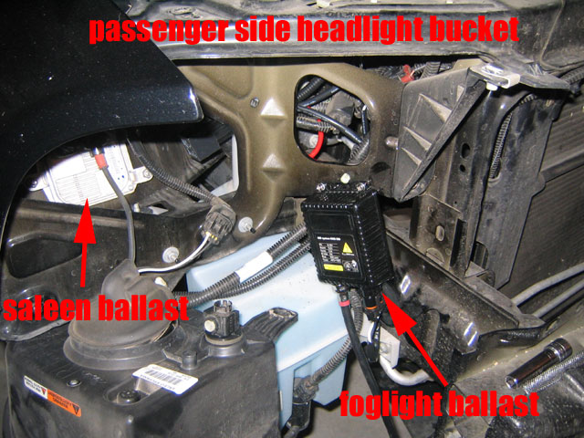

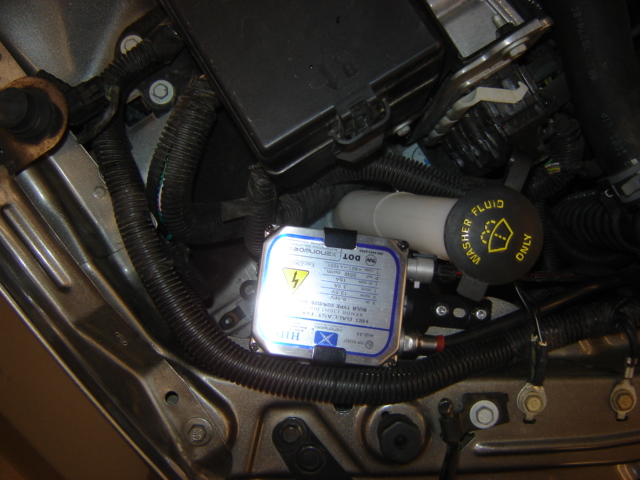

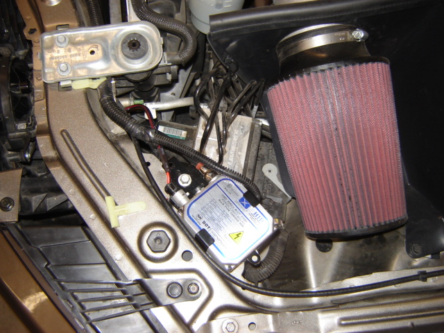

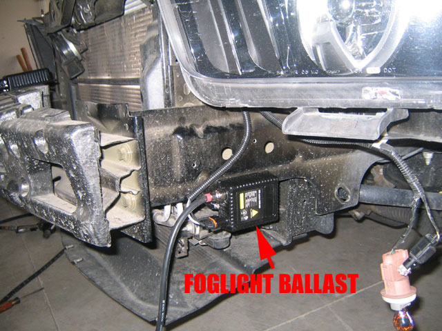

Agleon, I have installed HID foglights - It's a PITA.
You will need to mount both ballasts somewhere along the core support - that means removal of the front bumper and grille. I ended up mounting my ballasts in the headlight buckets.
You'll then want to tap into the main power block for the startup power. Your foglight circuit only serves to energize the lights, but doesn't actually power them (the 10 gauge wire to your power block does).
I have photos of the install if you are interested.
Bottom line is I would only do this install if you are interested in "HID" light, which means either 4300k or 6500k.
If you do 3000k IMHO you are wasting your money and time - just buy Silverstars for $40 and call it a day.

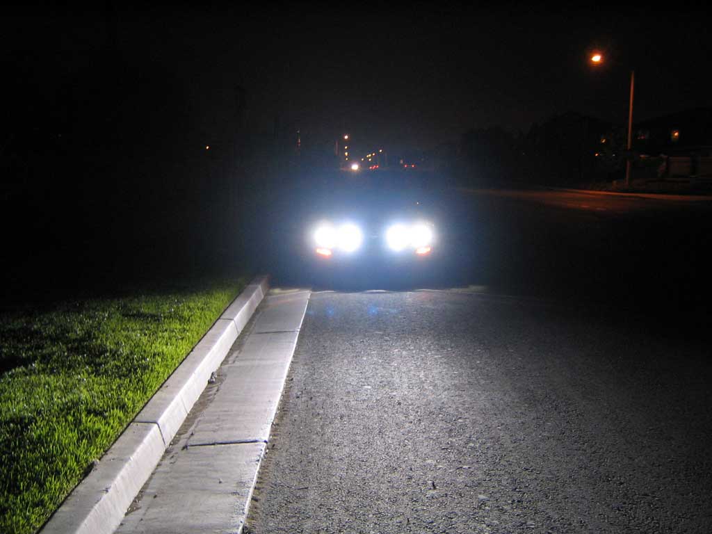

To me that looks extremely bright and that it's going to produce good lighting. Also I just read this about 3000k HIDs "The 3000K capsule is actually a 5000K capsule specially coated with a film that filters out all the wave length except the range of wave length which emits yellow."
Old Mar 24, 2007 | 12:38 PM
kevinb120's Avatar
Posts: 6,730
Taking a picture of any light bulb at night tends to look bright. Being that the lights are way to low to be effective at much of anything, its an eyesore for oncoming drivers more then anything else.
