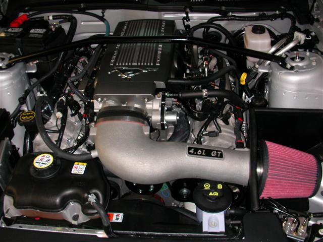

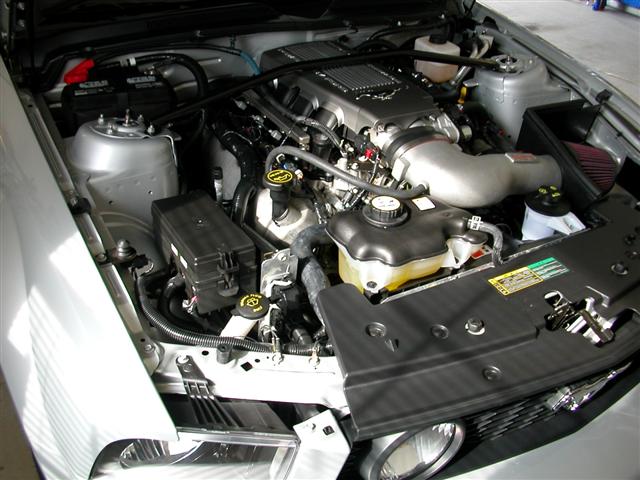

If you read the thread you will see that KC has even posted the part numbers that you will need for the nuts for the 07's. Again, the studs are already on the 07's, so you don't need them, just the nuts. There are photos of each on the thread. Yes, some folks with the 07's have reported rubbing, mainly because the hoodliner sags. You can either use double sided tape behind the hoodliner to prevent the sagging, or you can install a strut tower brace to prevent the hoodliner from sagging which is what I did on my 07. I did not have any sagging before I installed it however, I just wanted a STB. See the photos below with the STB and Engine Cover installed on an 07 GT.

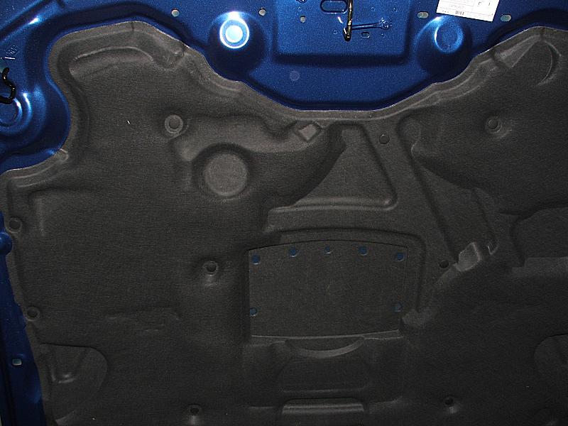

I've got an '06 & have the same liner as you, I've marked where the liner rubs on the intake cover. I haven't done the carpet tape yet, as I'm installing a Shaker scoop soon,I just keep a old washcloth on the intake cover where it contacts the liner. It will rub the paint off the fins on your cover if you don't address it.
