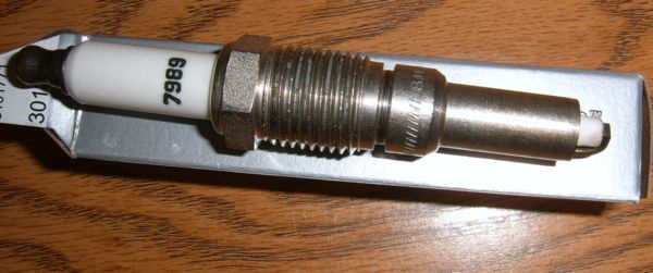

Posts: 59
From: Alberta
Originally Posted by randy_tho
I just put in the champions today. I inspected them well and they looked good and they were in spec.
Mine weren't quite so good. After about 6 miles car ran like crap and I discovered here's why: SUC52282.JPG
Got an email to the supplier to see what he's going to do about this as I brought these back in December and put them just a couple of days ago.

Posts: 59
From: Alberta
Defective Champion plug 7989 from RockAuto.
RockAuto (internet store) said I could ship it back at my expense and they would send me another at my expense which would cost more than the plug was worth. Told me it was more than 30 days since I bought them.
Called Dave Renault of Federal Mogul (Champion plugs) in Ontario and he went the extra mile (good will) and arranged to have the defective plug replaced at my point. RockAuto and Federal Mogul in the USA weren't much
help and don't appear to know the definition of "good will".
