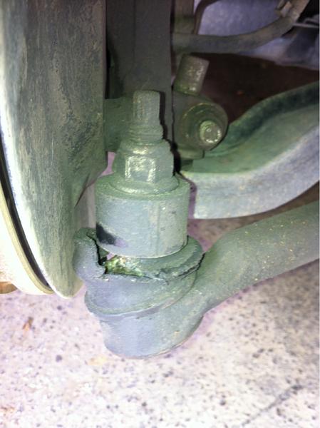

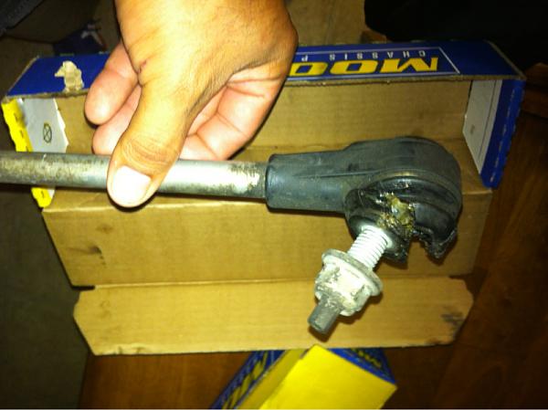

just replaced sway bar links. next week tie rods inner and outer.
Old Oct 20, 2012 | 05:42 PM
How many miles?

100k..

yep, thats when i had to do mine too about 100k. my tie rods looked just like yours. i got the sway bar end links from cj`s. they were a little thinner than oem but they had joints that you can put a end wrench on the back while you tighten the nuts. i also did the frt control arms/ball joints. used the frpp arms. in the last yr they have gone up $150 if i saw it right. everything is going up lately.

yeah... i went with moog sway bar links and tie rods.. they are solid and not hollow.. also have grease fittings... good stuff
