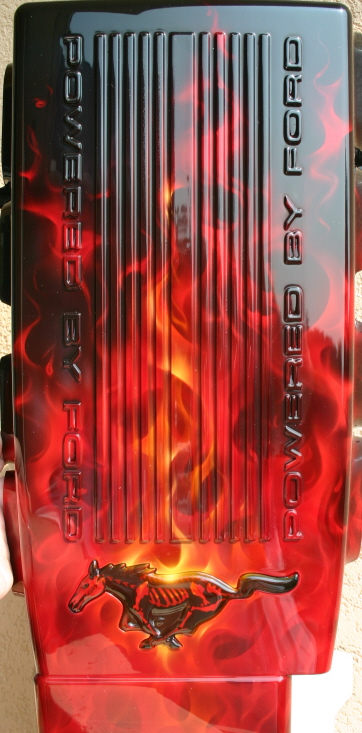

Hey guys , heres a shot of my personal factory plenum, this is the first ford piece we have done. High quality part, was a pleasure painting. Email me at hireman356@aol.com for pricing info for paint jobs on your covers or painted covers directly from me. Remember , we do ALL factory basecoats with fire or many other designs. And as always , the pic doesnt do the apperance any justice at all. Click here to see the designs we've done so far. www.uniqueautomotivedesigns.com/id71.html
I used mostly red candy on this as anyone who knows my car knows I got the black and red thing going on.......my steeda hood , which I'm finishing up will have more yellow and orange in the fire and of course the hellhorse...LOL!....will post pics soon

WOW!
Impressive.

Nice, alot of quality time spent there.

Hey Hireman, any advice on removing the pony? It seems to fit in there pretty tight and looks tough to mask. I'd hate to break it, but I am wanting to paint the cover the same color as my valve covers and want to keep the pony chrome. The fins and lettering should be easier to re-paint. Help?

It really comes off easy, at least this one did. Its held on with some type of sticky foam...not 2 sided tape ( which I would use to put it back on with). I just used a small screwdriver to get the head up and peeled it up. Its also a very strange part......it is pressed out of aluminum sheet then they fill the back of the cavity with some sort of clear plastic material the put on the sticky foam...that pony probably cost less than .20 to make...LOL. If it acts like it doesnt want to come off easy try putting some water around it and let it soak in....when I wet sanded my cover what was left of the foam got wet and it really peeled off easy then.

Ok, the pony did come off without damage, but not as easily as I had hoped. I used dental floss and a very small screwdriver, but having the feet already lifted helped some. The rubbery glue is strong as an ox and difficult to remove. Water didn't help, and "Goo Gone" and "Oops!" weren't that great, either. I did, however, find out why my pony was kicking up his heels. The clear filler poured into the back of the stamped aluminum wasn't level. It was a little concave at the top, and bulged out at the feet. Now I'll just sand or cut that down so the whole horse lies flush into the recess. I'm going to try to do the fins and lettering in aluminum vinyl. I'll post pics when I get done.
Edit: Forget the aluminum vinyl. The sheet it came in was a perfect size, but had the grain going the wrong way, so the brushed effect would go across the fins, not along them. Duplicolor Chrome paint applied with a foam brush did almost as well.
