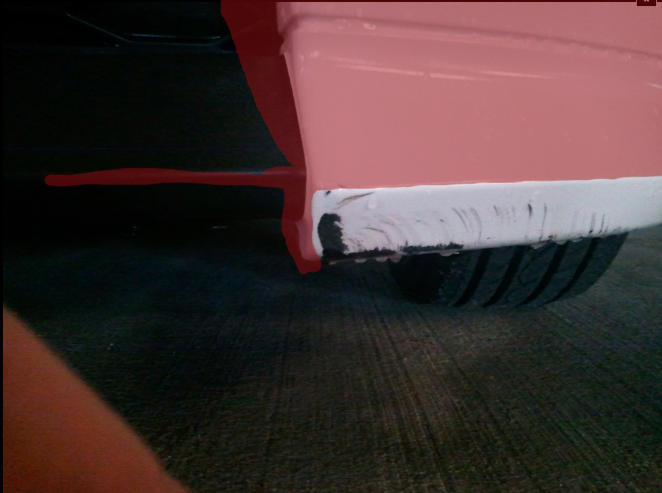

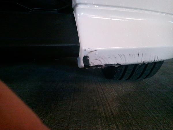

So I'm trying to get my mustang to near perfect condition since I just bought it. I've already replaced the tires and the front rotors and brake pads so now I'm trying to fix a few minor scratches on my car. They are located on the front fascia (hitting curbs). What would you guys recommend on how to fix these scrapes? Spray can or what?

Eeee, that looks rough. I think you can get touch up paint from a dealer or a body shop. I'm sure someone else on here can help you with the color code. That'll probably be better than some random white spray paint...

oohhh, thats more than touch up paint can fix and look decent...I'd call one of those dent repair/paint guys the car dealers use, they can airbrush that section for you.

You could do it yourself, you just have to be careful.
Because it's white and not metallic it will be very easy to match AND bonus, you can use the crease of the bumper to be your stopping point so that would make it even easier.
Mask the red part with tape and paper.
Then you'll want to clean the area obviously , then you could spray and it should work.
Or you could just paint it with a brush. It will be noticeable to you, but to most people they won't give it a second glance.

Sorry had to upload the pic
If I were you... I would hand paint it.
Here's why.
If you spray you'll cover the black, but you'll also cover the other paint, which may or may not cause some discoloration. The paint that's on there isn't new so there will likely be a slight shift in color.
If you paint it with a brush then you can just focus on the black parts and you could "fill" the scratches with paint much easier than trying to spray it which will not really fill it. You'd have to sand and that's more trouble than it's worth.

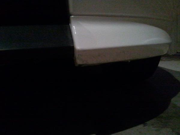

Thanks for the help guys. I did this last night. It's not anywhere near perfect, but it looks 100 times better.

looks better man, after the second coat you probably won't even notice it anymore

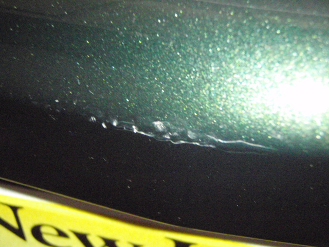

While parking my Bullit in the garage, I inadvertenly pushed the bumper against a cinder block wall.
I have damaged the nose and it looks like the clearcoat and paint are cracked (about 1" long). The damaged area feels rough to the touch.
While you cannot notice the damage from a distance, I would appreciate any advice on repairs.

You could try to buff it, but because it's on the edge and on the bumper I would only use something by hand.
But I doubt you'll make it much better.... i.e. it won't be perfect unless you pay for a re-paint.
