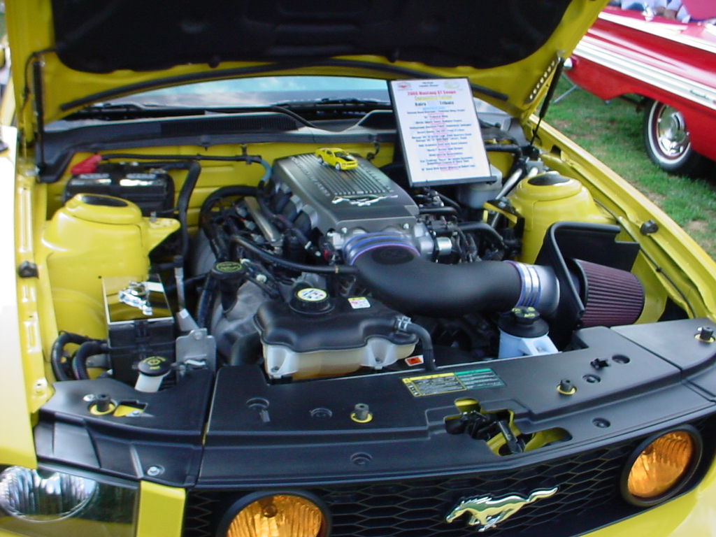

The plastic racer retains less engine heat, Racer has the highest air flow of ANY CAI (or it did for some time), and it is cheaper than the Street...
+1 Racer
